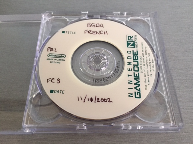

    I have just had a pm conversation with a user. We have a theory that the disc I have may actually be a from a non-pal region.
    He tested by putting a North American ntsc disc in his nr reader in Japan mode and he is getting the same error message I am. He also put a retail disc in and it said no disc, just like mine.
    Interestingly enough, Balder’s Gate (the nr disc I have) was released in North America and then in Europe later, which makes it seem like it would be weird for very many PAL prototypes (if any) to even exist. So the next step is to test that disc in an ntsc nr reader.
    Basically, I may have just fixed it and not known it because I was testing it with the wrong disc.

  16. oldengineer
    oldengineer Familiar Face
    Jun 23, 2006
    1,083
    71
    All Baldurs Gate builds are NTSC by default, here's a PAL build, marked PAL. Hope this helps.
