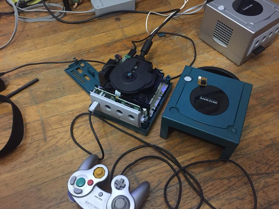

    29790922_2158369464392874_9177831006474573499_n.png Here's as good a place as any to leave off :p Will continue working on it as soon as i get a chance. I'm happy that we got at least one problem fixed, thank you all for the help
    I'm really just surprised at what terrible condition this thing was in... if you look next to the Av cable, you can see a piece of plastic that just fell off of it. The box is in terrible condition, and then a lid sensor and optical issue. What happened to this poor cube...
