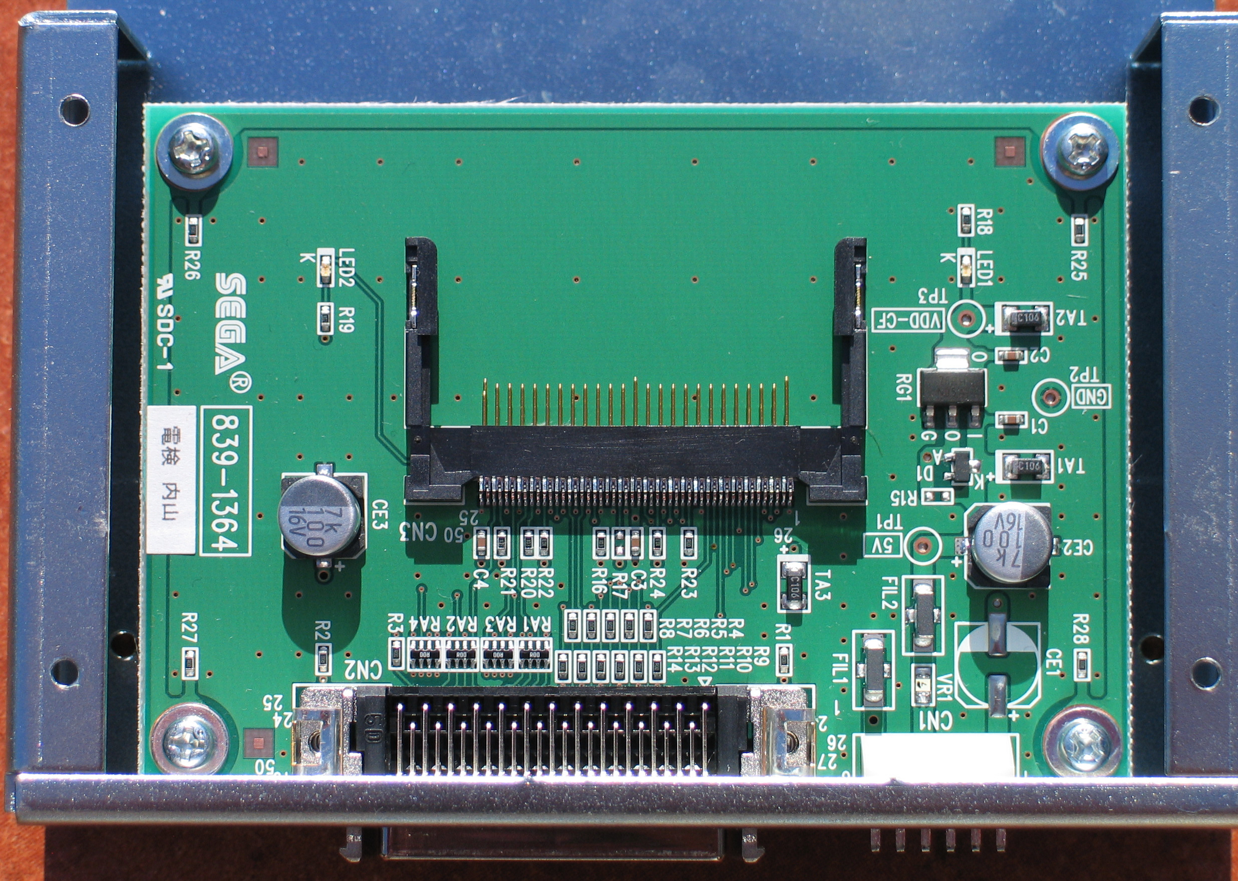

    That's really cool - had a look at a picture of the CF adapter, do you need to pull some lines high with a resistor array?
    http://kirurg.org/drop/naomi_cf_box.jpg
  5. MrSporty
    MrSporty Rapidly Rising Member
    Dec 29, 2006
    88
    Nope, it would definately be good practice to but i couldn't be bothered :p
