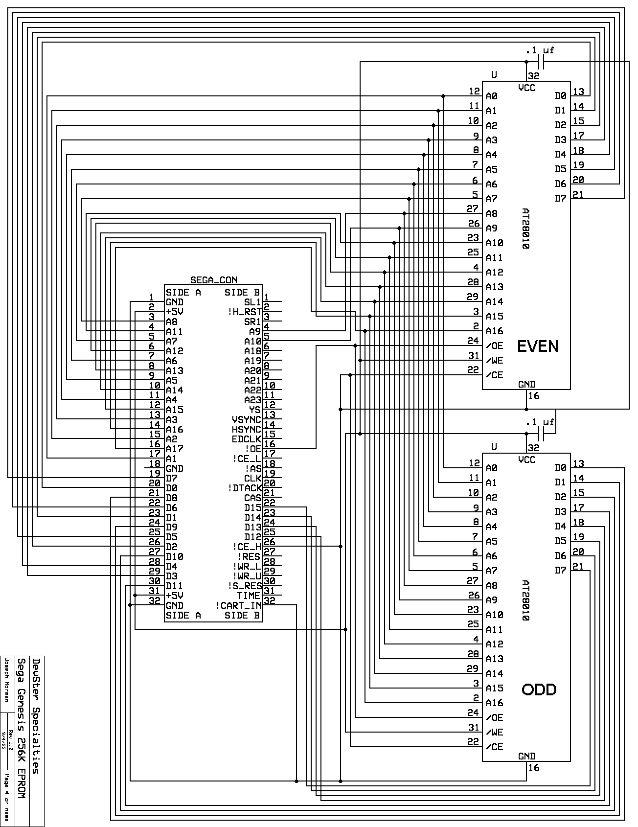

    You'll want series 27 CMOS EPROMs. You might want to take a look at this:
    http://devster.monkeeh.com/sega/segarom.png

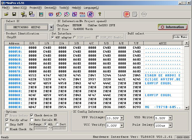

    Hi. Okay, then my problem is how to program the 42 Pin Chip. Do I need an adaptor. I have this programmer: http://www.ebay.com/itm/USB-MiniPro...PROM-FLASH-8051-AVR-GAL-PIC-SPI-/221092473435. There exist 40Pin to 42Pin adaptor but even if I had this adaptor I don't know which Chip to select because the 27C160 is not listed. Is there anotherprogrammer for this kind of Chip?
