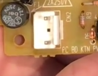

    https://www.digikey.com/products/en?keywords=A106608-ND Power Switch header
    you can also check out my 3d printed mount here https://www.thingiverse.com/thing:2308511 I have a list of parts I used to interface the PicoPSU with my Dreamcast
