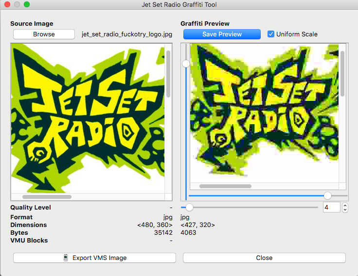

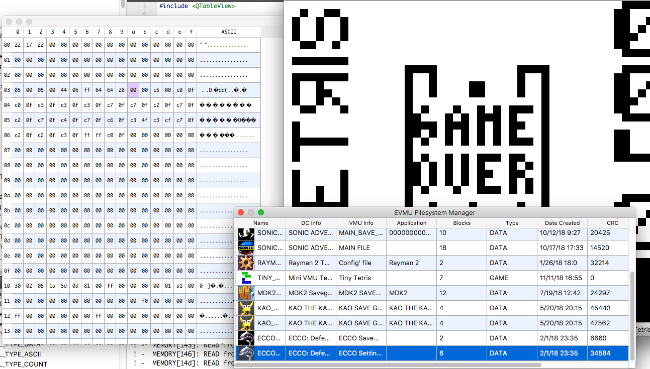

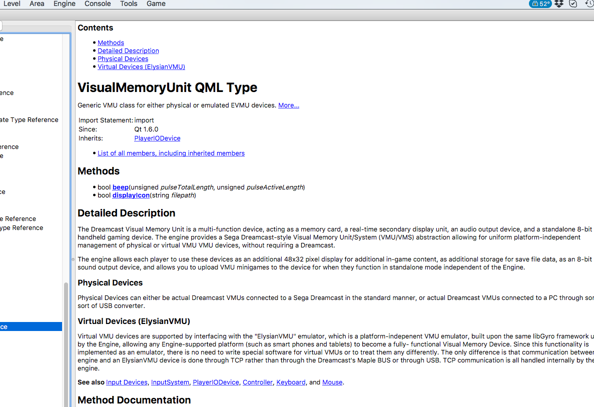

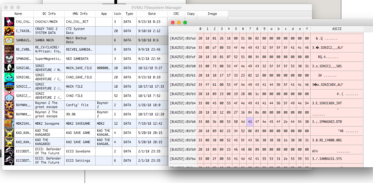

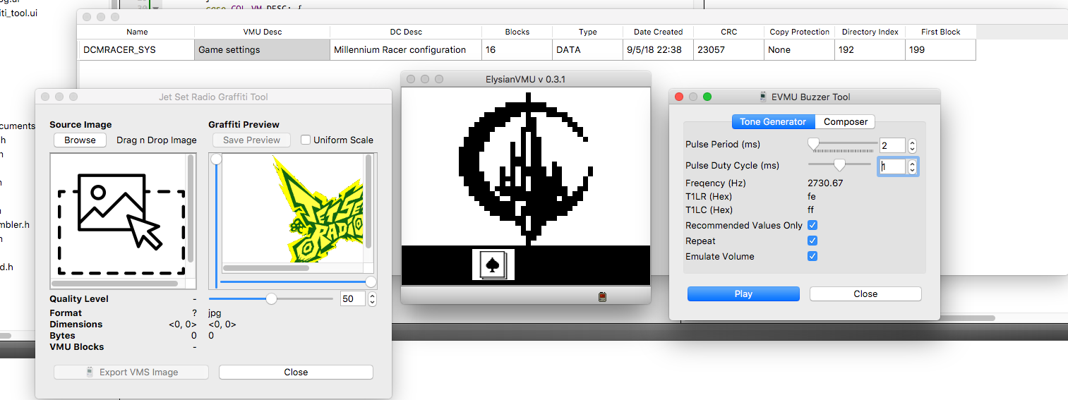

    Just to talk a little more about the ecosystem I was hoping this could be a part of (and maybe to try to help persuade you to consider my pain-in-the-ass needs, lol), here are some screenshots:
    Screen Shot 2018-02-01 at 2.09.10 PM (2).png This is our cross-platform SDK that I'm developing in parallel with Elysian Shadows, called ESTk, which will be released publicly after the launch of the game, which already has dozens of people who literally only backed us just to get their hands on it. You'll notice in the bottom right is VMU screen. It's actually an instance of EVMU running, so that during development, you can see what the VMU screen is doing, verify saving/loading, play minigames/whatever. Imagine your controller being fully supported by this ecosystem on a PC automatically just because I'm communicating with Maple packets... I know it's niche as hell, but I've convinced a lot of non-DC people that this might be a cool add-on to their game even if it isn't on the Dreamcast, because EVMU is also a phone app. this would be compelling in such an environment.
    Just a quick look at the built-in documentation for our SDK, showing how there's a unified "VMU" API that comes with it out of the box. Screenshot was before I added filesystem methods, but you get the point.
    Screen Shot 2018-11-11 at 5.20.51 PM.png Screen Shot 2018-11-13 at 7.09.05 PM.png Screen Shot 2018-10-17 at 7.14.10 PM.png
    Just a quick look at a bunch of the tools we're supporting... File system manager, custom icon creator, real-time memory browser and modifiers, JSR graffiti tools, flash hex editing tools, etc (even a buzzer tool for developers to compose VMU music, which could then be sent to the device over maple to preview! LOL!). I'm trying to come at this from all angles to create like the one-stop VMU combined ecosystem app that handles 1) all of what Dream Explorer did for file management 2) 100% feature complete emulator (including things like emulating vmu-to-vmu serial connectivity over TCP (wip)) 3) Acting as a slave device to be driven by apps/emulators by just sending Maple packets over TCP.
