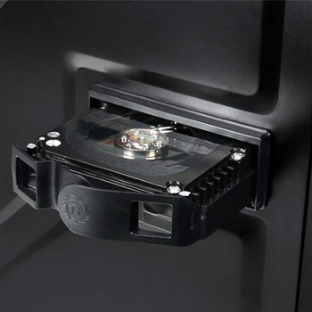

    I picked up a vista 32 I can run on my primary. My primary uses hot swap trays
    (thermaltake armor a6)
