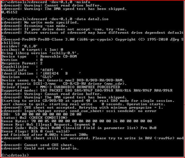

    cdrecord -dev=0,1,0 -msinfo shows 45152
    cdrecord -dev=0,1,0 -data data2.iso fails

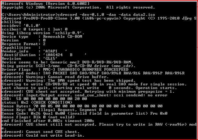

    Some cd burners got problems with multisession in track at once, try in disc at once (which means session at once actually). Also, data1.iso should be 69120000 bytes, make sure it's the case.
    Try this:
    cdrecord -dev=0,1,0 -dao -multi -data data1.iso
    Should output 0,45000
    cdrecrod -dev=0,1,0 -dao -data data2.iso
    FG

    With those commands the first part works, the second part can't use the buffer but 'appears' to do it but the 3rd part doesn't like the CUE shet etc and reccomends writing in raw mode, which then dosn't work because it can't write the lead in (because I think it was already written in step 1 in DAO... well that and this is scond session other bit is first and raw is on session?)

    Try to burn two 39332496 bytes track for the 1st session:
    dummy.exe fuck.raw 39332496
    cdrecord -dev=0,1,0 -multi -audio fuck.raw fuck.raw
    Should be 0,45000
    cdrecrod -dev=0,1,0 -data data2.iso
    You might need the -dao option too.

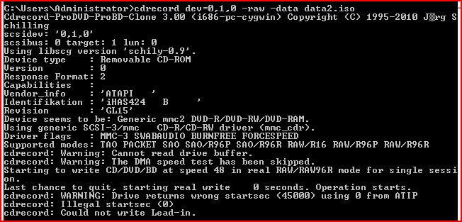

    BTW I just tried your newer fuck.raw thing that part worked, middle part was same old, but same shit with data2.iso with or without -dao no joy, it reccomends raw mode again which then wont work for reasons previosuly mentioned (which I have attached below) - note th wrong startsec of 45000 then returning to 0? Probably related to raw write only though.
    What ever magic Daemon tools does we need to either replicate or mke it work without errors.
