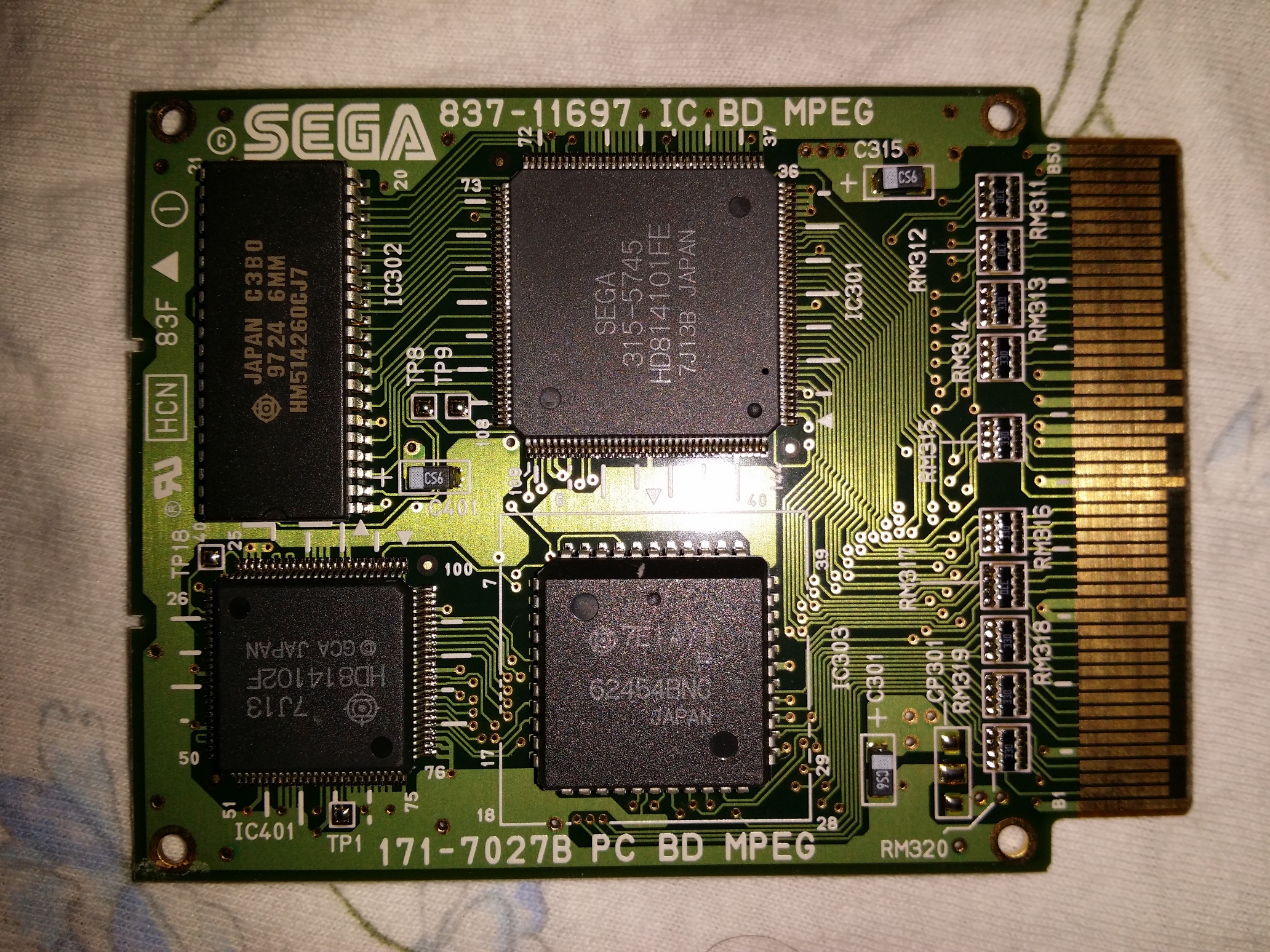

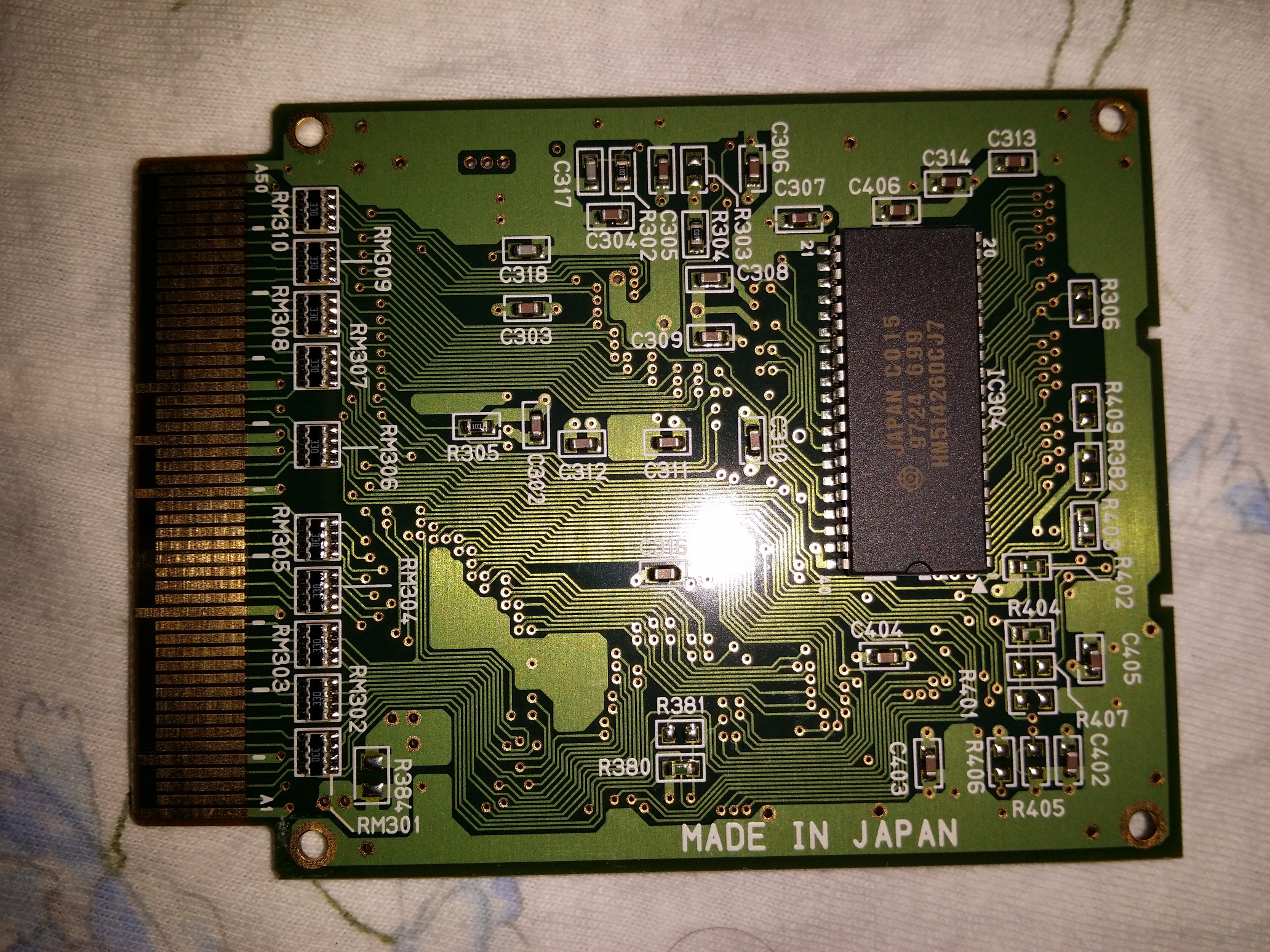

    The SH1 ROM checks 512kB with random data when you run the Authenticate MPEG Card command. If it doesn't pass, it won't boot the card ROM. Guess it's another security measure - you can't just plop a ROM chip in the slot and run a nice little modchip program.

    While on the topic of documentation, the Hardware Flags from Get Hardware Info are:
    0x80 - LSI or DRAM tests failed at startup
    0x02 - MPEG card is present (reading a chip register succeeded and the IRQ lines toggle)
    0x01 - there is a stubbed-out test in CDB105 which never sets this bit
