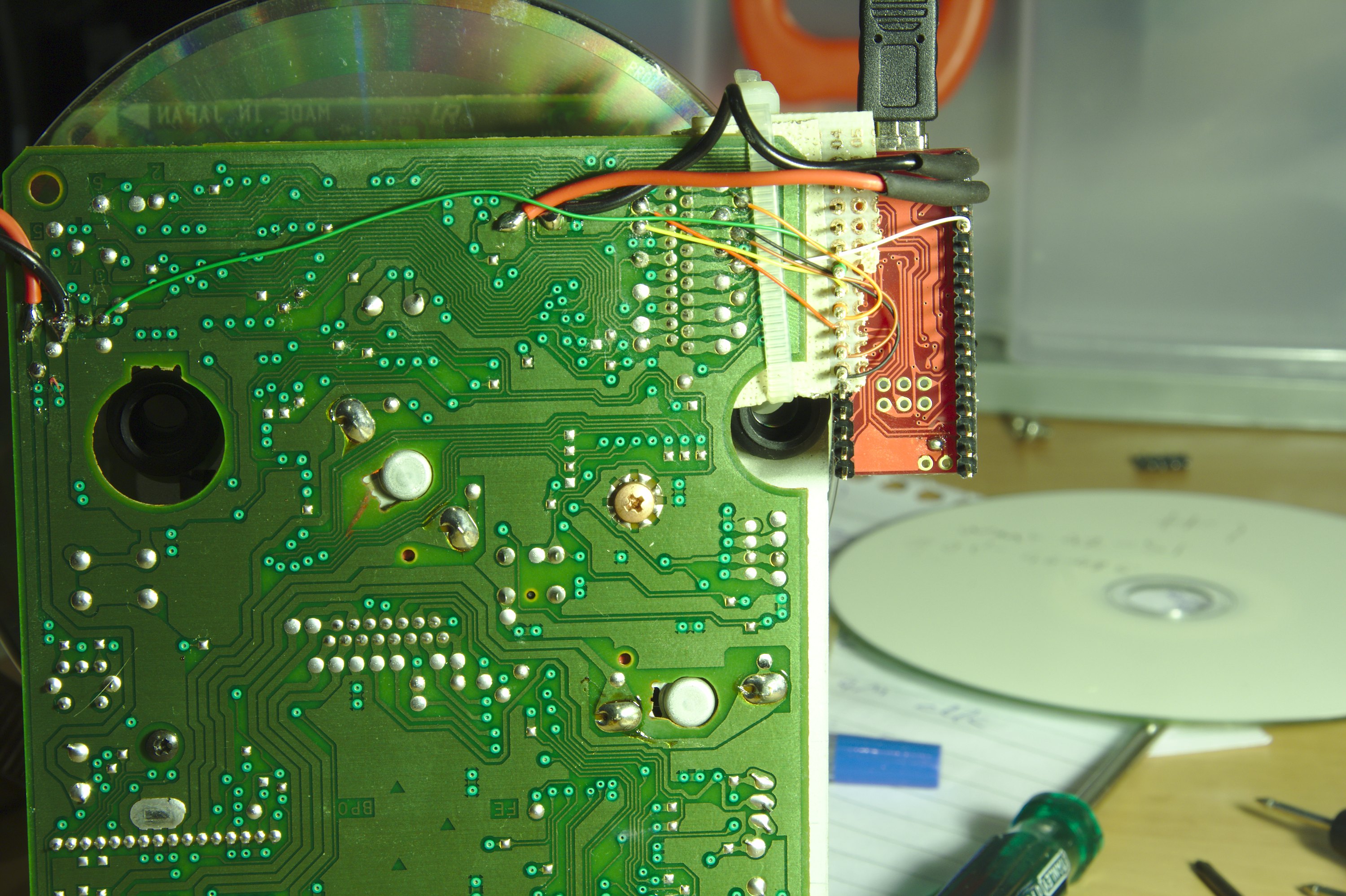

    After burning a bunch of coasters with everything down to the Q subchannel correct based on public ring data, I decided to go seek out some answers (if you'll pardon the pun) in the drive itself.
    I took the drive out of my VA7 Saturn, and attached a little atmega32u4 breakout to it, to the command and status lines. Now I have a pet drive that I can control over USB, including issuing the all-important ring seeks. Here's the assembly on my stupendously messy desk:
    And here's a detail of the connection to the data bus. The green wire snakes off to control the door closed pin:
    There are two sets of power wires, because this particular drive really doesn't like having the drive motor noise on its sense-side power supply. The left wires supply the drive motors from a benchtop power supply, while the right-hand ones supply the sense and control circuitry from USB.
    I then used this rig to issue seek commands to ring data as well as regular data, both on burned and real discs.
