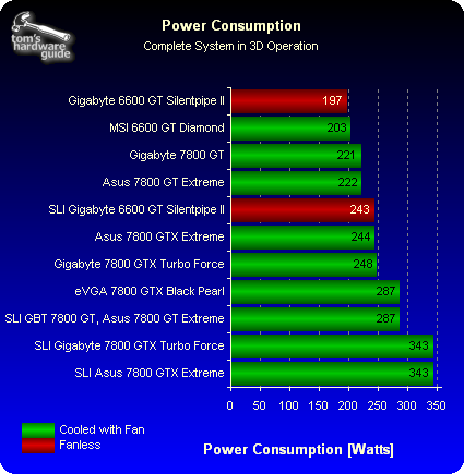

    Parris
    if you ever manage to get yourself a lindbergh, DONT BUY THE ORIGINAL PSU
    i know you will want to buy it, but dont do it.
    I had tons of problems with the original PSU, problem is mainly that original psu is 240W and if you run the board with a nvidia 7800 gfx card you will end having trouble cause this card itself draws more than 240W.
    I was experiencing 10fps on some games, hdd blinking and crashing and so.
    I bought me a 600W atx psu and problems solved, but it was a nightmare to find the problem.
    My board came with a 6800gfx and i upgraded it with a 7800 bfg overclocking edition, i asume segas original 7800 has some custom bios that runs the card at low end mode or so.
