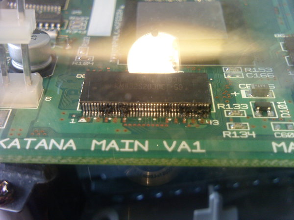

    Interesting. I actually tried to do a RAM doubling hack in 2009.
    I took 2 DCs, desoldered the RAM from one of them to use on the second. Stacking two chip on top of each other just barely works if you bend all the legs from the donor straight down. I left one address line string out into the air and planned to attach it to CS2, no drilling should be needed for that, just a bit of wire. See some photos I took at the time:
    I even have finished code somewhere in preparation of finishing this hack, but unfortunately it ended with me blowing the thing up. Result:
    I can't quite figure out what happened here. If I could I would try again. I'm pretty sure I didn't short anything because I went over and checked all contacts 3 times before turning the power on.
  8. Bad_Ad84
    1,308
    You cant just stack the ram, you need to use the extra address (or chip select line) line to enable/disable the chips to switch between them.

    Quite, but even missing that it shouldn't blow up.
    The chip select leg was left up.

    2,324
    I haven't tried it, but the Micron MT48LC4M32B2P (any speed grade) looks like a good bet.
    Pinout is almost identical - the only difference is pin 21, which is NC on the original chip and A11 on the Micron part.
    Mode register bits are the same (the Micron also supports CL1, which the Samsung part doesn't)
    Both devices have 4 banks, 256 column addresses and use 64ms 4096 cycle refresh
    In theory, all you should need to do is connect the A11 input pin to CPU_A21 and it should work...

    VA1 MB:
    Bottom Side Between SH4 and PVR is R147.
    Connect a wire on the side closest to SH4 is CPU PIN 15 - A19: Pulled U/D on R147
    Bottom Side Between SH4 and PVR is R122
    Connect a wire on the side closest to SH4 is CPU PIN 14 - A21: Pulled U/D on R122
    Swap Stock 86TSOP Ram Chips With MT48LC4M32B2P x2
    Send the two additional Address lines to PIN 21 on each SDRAM.
    =32MB ?
