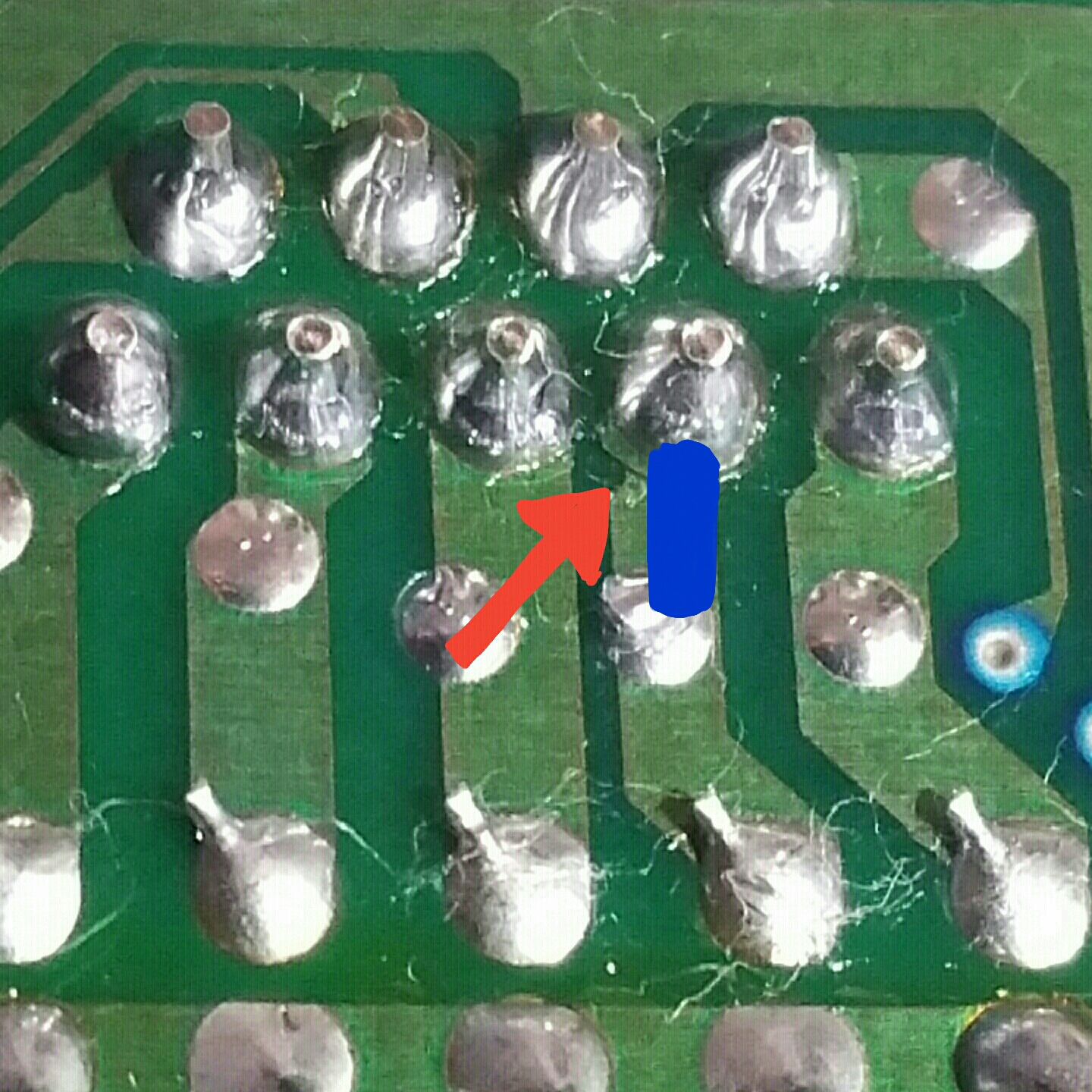

    Well I've looked around the forum and I saw that I and other people had similar issue and this may be a potential fix. As I was playing the other day I plugged in my 6 button controller (which was working and worked in port 2 correctly) and then poof, I couldn't go right on any game.

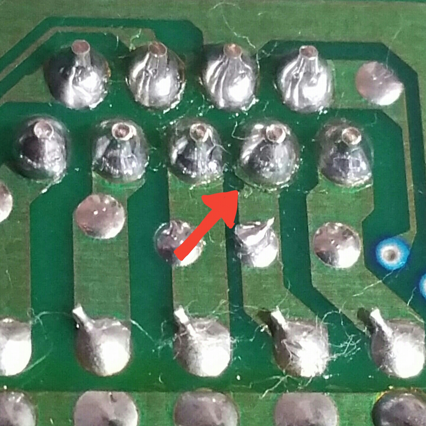

    So I found that many people said a reflow of the pins helped them. Tired it and didn't work. Upon further inspection I found a crack in the trace.
    Patched it with a resistor leg i had laying around to the convenient solder point below it and it worked flawlessly.
    Probably cracked from stress. But hope it helps someone.

    Looks like the socket was installed improperly - if you look underneath the other pins on the second row of that connector you can see the traces have started to lift (the pin to the right of your blue line shows it clearly, with a visible crack in the right-hand side of the trace). It might be worth reinforcing all the connections just for safety.

    I saw this on a Master System 2 motherboard, they're not known for being the best quality though.
