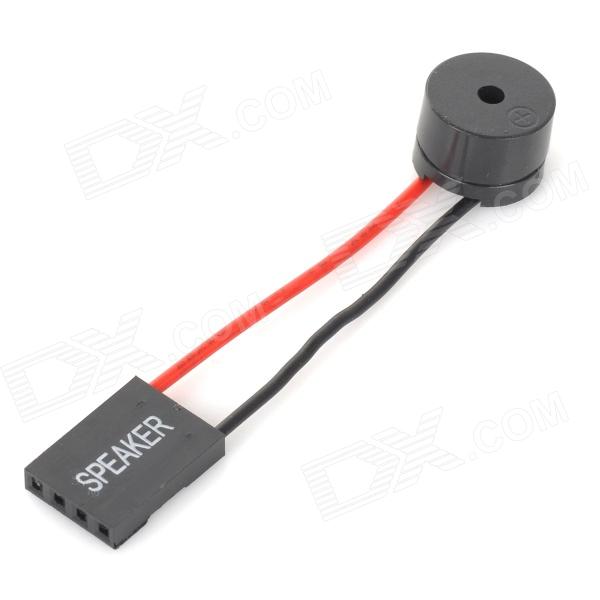

    So anything is really silent at all. But i found another noisy spot. I marked it in the picture above. Its some kind of buzzer. Sounds like a HDD lol??? Anyone know this part? Is it maybe damaged? Sound from the buzzer is on startup some clicks and after that a noise like a running HDD. Not so loud but...

    Looks to be on a riser board, perhaps a PC speaker?

    Sure i searched before and found it. But im looking for a new one, not as mine in a unknown condition.

    It's a PC speaker for error beeps. I'd keep it.

    So i replaced the buzzer but its the same noise so i think its normal...

    I think i found the problem with the buzzer.
    The battery are empty lol.
    I checked it and it has 0.3V, without battery the buzzer is quite...
    So i replaced the old buzzer and order a new ML2032.
    But im not 100% sure. I also reflow the blue cable.

    got it back. was a short on the solder point. Such old hardware is a nightmare to solder...
    So it work correct. Got also the new ML2032. Work also fine.
