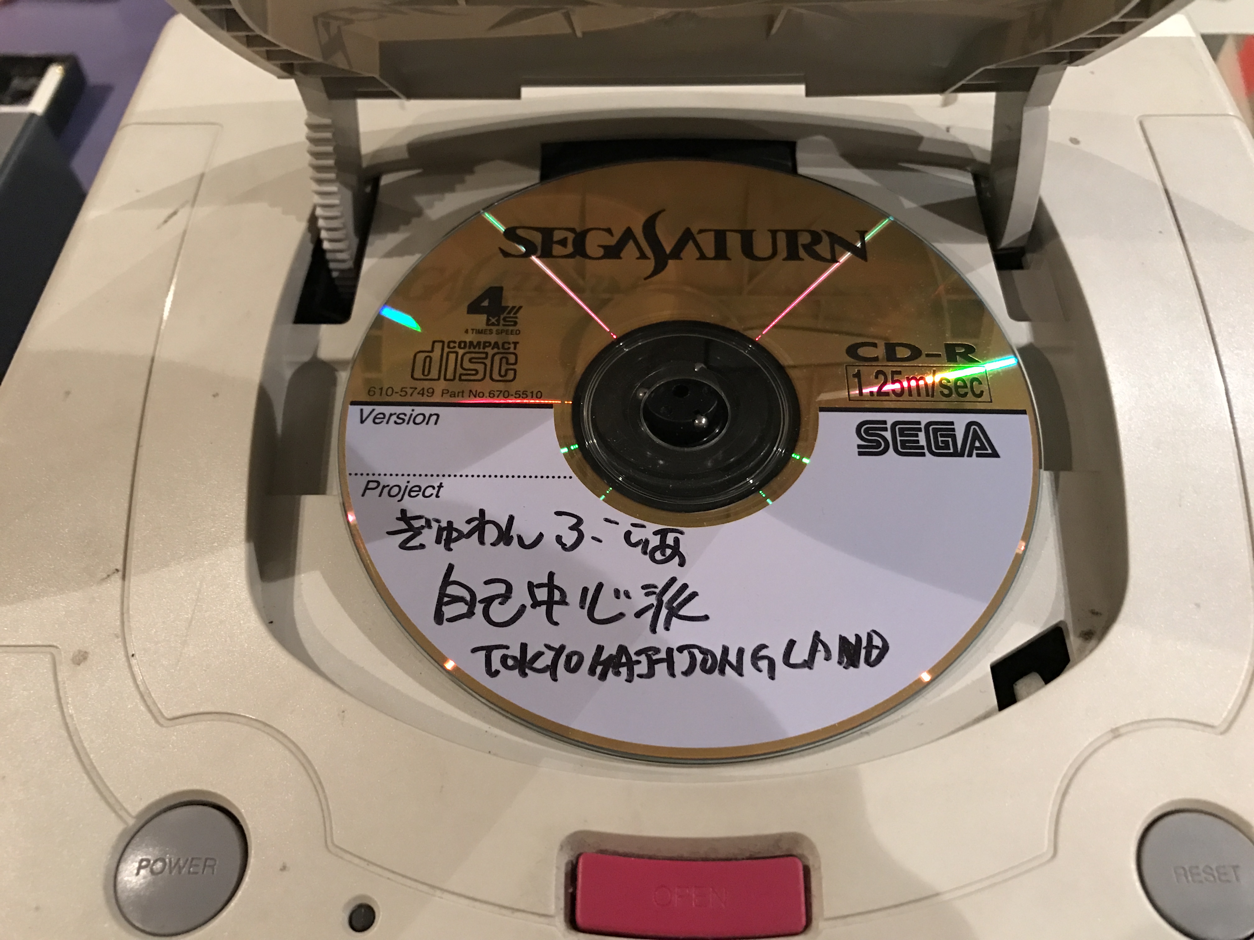

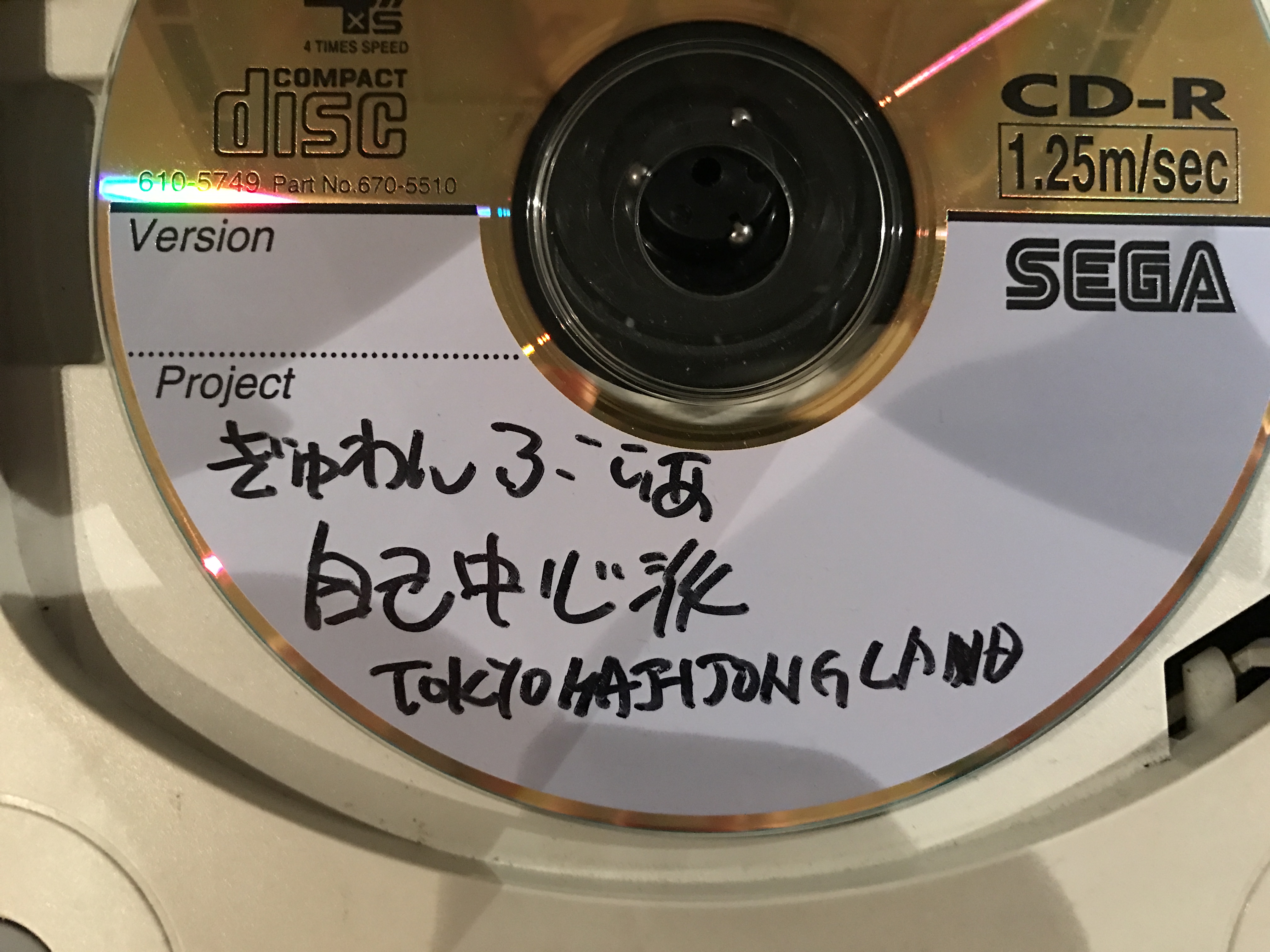

    Wow great info! Interestingly one of these contained a burned Saturn development disc when I received it. I've only attempted to boot it on both these consoles; which it doesn't. Wondering if it needs an external tool to boot (came with a PsyQ kit (the blue cartridge version and PC Card, and another cart that looks like a memory expansion) or whether the disc deteriorated. Both consoles read music CDs fine but I haven't tested with any game discs yet.

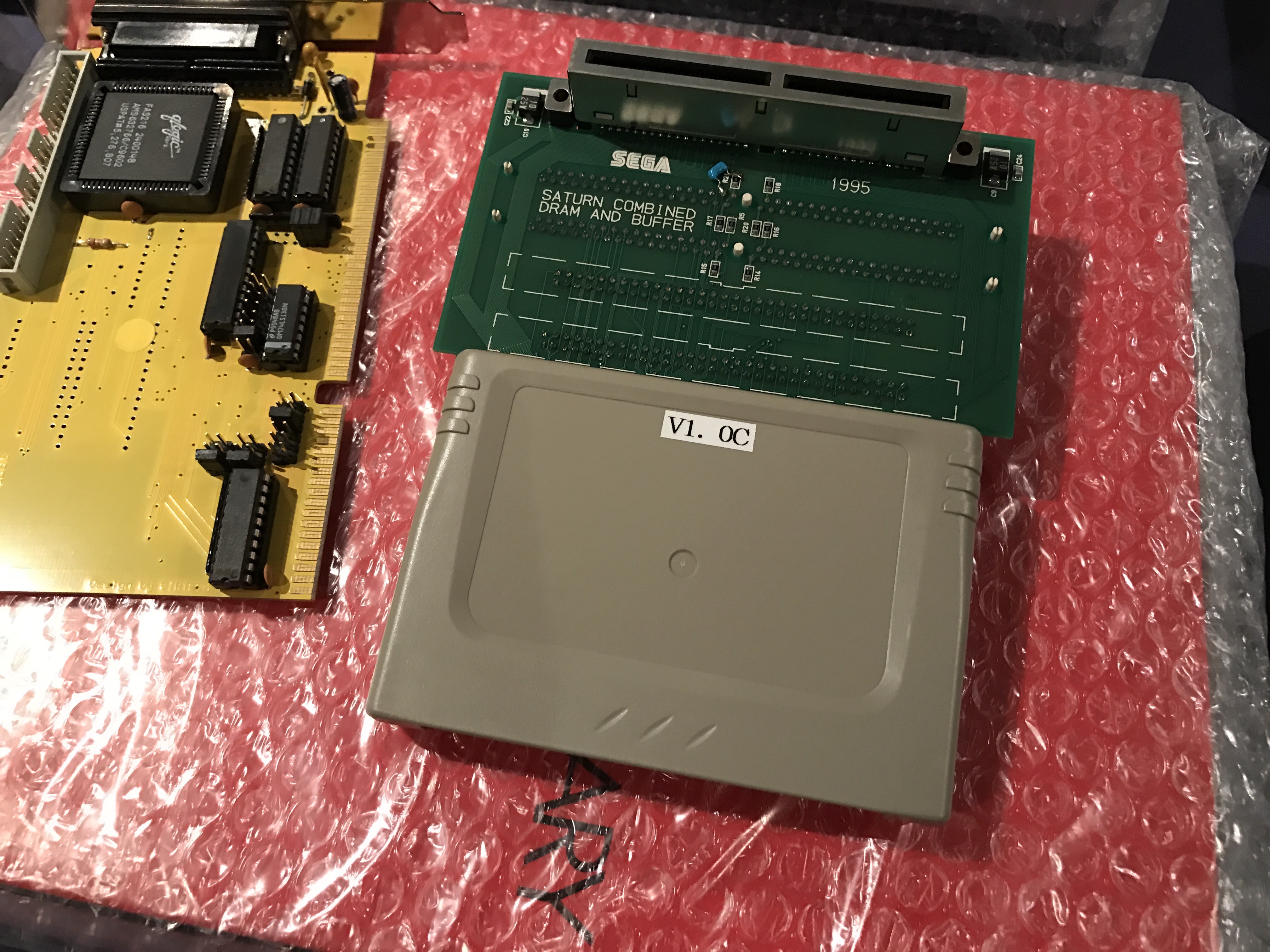

    It's hard to tell what is on that CDR without opening the disc in a PC. It could be a final game, a prototype build, a bootable game that doesn't work because neither system has a working laser, or the modchips don't work, or it could be just an asset disc, or the disc might not have a game but the DSK development images that was used by the devkits to emulate a disk drive.
    The other cart is for the Cartdev devkits, I believe.
    It might work but it will need a secondary cable soldered for the clock signal, like in those very very old modchip install guides.

    Wow thanks, yeah I intend on opening the disc up on my PC tonight.
    I thought it looked a bit like those cartdev carts, bit strange it just came by itself but was a weird auction lot.

    Here's the CD-R contents from Windows; iTunes was able to import a number of AIFF audio files from the disc too.

  8. Droid III
    Droid III Rising Member
    Nov 22, 2017
    68
    41
    Looks like the final game to me, all the file dates have a +10 hour offset but that can be put up to timezones.
    The best way to check is if you could share the MD5 sums for the files in the disc, then we can check if the files match the final game files or not. Note that the CDDA files may not be readable because they are sort of symbolic links to the cd audio tracks.
  9. Shane Battye
    Shane Battye Spirited Member
    Oct 28, 2017
    163
    165
    xml database contents (I used Microsoft (R) File Checksum Integrity Verifier V2.05 to generate it from the CD-R)
    <?xml version="1.0" encoding="utf-8"?>
    <FCIV>
    <FILE_ENTRY><name>e:\0</name><MD5>/prWeCXsw1PKg+UvtZ4HUA==</MD5></FILE_ENTRY><FILE_ENTRY><name>e:\ANIME.BIN</name><MD5>/mwwpUrftOi9ZxEoF4IyRg==</MD5></FILE_ENTRY><FILE_ENTRY><name>e:\ASCII.FON</name><MD5>gZ4z+/AqyU3nkXeaxByB+g==</MD5></FILE_ENTRY><FILE_ENTRY><name>e:\ASIFNT.DAT</name><MD5>YcAXSAvYaud3JMo5ozRCCw==</MD5></FILE_ENTRY><FILE_ENTRY><name>e:\ATARI0.DAT</name><MD5>1HDEYQ9/jnClqYRZbo+Xwg==</MD5></FILE_ENTRY><FILE_ENTRY><name>e:\ATARI1.DAT</name><MD5>4uJP0r7gjvhYO7dRKE1fbA==</MD5></FILE_ENTRY><FILE_ENTRY><name>e:\ATTRAC04.DAT</name><MD5>J1Jfi/ZHx779+wEP+91Eaw==</MD5></FILE_ENTRY><FILE_ENTRY><name>e:\ATTRAC50.DAT</name><MD5>dal5vYmP+9ZO1McX/7lwAA==</MD5></FILE_ENTRY><FILE_ENTRY><name>e:\ATTRAC51.DAT</name><MD5>5ZGtsWRVIz189L5Yet7BLQ==</MD5></FILE_ENTRY><FILE_ENTRY><name>e:\ATTRAC80.DAT</name><MD5>3Etijs2YJy4SlgkbtcxjRA==</MD5></FILE_ENTRY><FILE_ENTRY><name>e:\ATTRAC81.DAT</name><MD5>5LAIC7hrv/ZfDHWw24NMfA==</MD5></FILE_ENTRY><FILE_ENTRY><name>e:\ATTRAC82.DAT</name><MD5>gXyh+EIa3k46il3UWr2E2Q==</MD5></FILE_ENTRY><FILE_ENTRY><name>e:\ATTRACBG.DAT</name><MD5>HpVoPc2gb0KBRCM57nRnbA==</MD5></FILE_ENTRY><FILE_ENTRY><name>e:\ATTRGIRL.DAT</name><MD5>LjgA4KBTvtyXzjGxLlAeUQ==</MD5></FILE_ENTRY><FILE_ENTRY><name>e:\BG_IMG.DAT</name><MD5>bmww+mZMrtGO0Iz1XJyzeA==</MD5></FILE_ENTRY><FILE_ENTRY><name>e:\BG_LOGO1.DAT</name><MD5>Bjf2VvbXio/LvbvPoiBX5w==</MD5></FILE_ENTRY><FILE_ENTRY><name>e:\BG_LOGO2.DAT</name><MD5>MfGaE0fXo6z7vqBHSC97Jg==</MD5></FILE_ENTRY><FILE_ENTRY><name>e:\BG_X3.DAT</name><MD5>DEtcLz9dD7Qp/YVKx1KBXw==</MD5></FILE_ENTRY><FILE_ENTRY><name>e:\BUNNY.DAT</name><MD5>ULVUa539sSF9WKavQBqA+w==</MD5></FILE_ENTRY><FILE_ENTRY><name>e:\CAGASELE.DAT</name><MD5>U0SXBspOMnk5lXQta2chcw==</MD5></FILE_ENTRY><FILE_ENTRY><name>e:\CASHIER.DAT</name><MD5>y48awYNPkJy0z4BBxLGWRw==</MD5></FILE_ENTRY><FILE_ENTRY><name>e:\CASINO.IST</name><MD5>L9Ww7CAnGQPXV09ttU5tfA==</MD5></FILE_ENTRY><FILE_ENTRY><name>e:\CASINO.SEQ</name><MD5>Vwdr39y7da0Gf+DLAvLMnQ==</MD5></FILE_ENTRY><FILE_ENTRY><name>e:\CASINO.STB</name><MD5>Xzd++9E1+Y98zG/WRNm9mw==</MD5></FILE_ENTRY><FILE_ENTRY><name>e:\CASTLE.DAT</name><MD5>mDaqRsNlti3gv/FGC4xa9Q==</MD5></FILE_ENTRY><FILE_ENTRY><name>e:\CASTLE2.DAT</name><MD5>1bQeqfvzRZJwjSaUdh+jWA==</MD5></FILE_ENTRY><FILE_ENTRY><name>e:\CHARNAME.KNJ</name><MD5>b8MbsYh45hVuL8gciSfwWQ==</MD5></FILE_ENTRY><FILE_ENTRY><name>e:\CHAR_IMG.DAT</name><MD5>wFh7mjJRHrFI94KPFUz0iA==</MD5></FILE_ENTRY><FILE_ENTRY><name>e:\CHRFACE1.DAT</name><MD5>f6Nq8MYIH/bg6catwMi3Cw==</MD5></FILE_ENTRY><FILE_ENTRY><name>e:\CHRFACE2.DAT</name><MD5>o0Tconv1q6qB0X+kuWryDQ==</MD5></FILE_ENTRY><FILE_ENTRY><name>e:\CHRSER00.DAT</name><MD5>xHoy8vzR00wEcvs+IuKTBg==</MD5></FILE_ENTRY><FILE_ENTRY><name>e:\CHRSER01.DAT</name><MD5>6RHyaUz3dCTgA1Pkg+WBxg==</MD5></FILE_ENTRY><FILE_ENTRY><name>e:\CHRSER02.DAT</name><MD5>LuK+Dm1Dsgen1UuP82CXlA==</MD5></FILE_ENTRY><FILE_ENTRY><name>e:\CHRSER03.DAT</name><MD5>wOCxQ0/RssK6Kb1DKl10Ew==</MD5></FILE_ENTRY><FILE_ENTRY><name>e:\CHRSER04.DAT</name><MD5>GvqCdoDtzcWlPJzCgKWcnw==</MD5></FILE_ENTRY><FILE_ENTRY><name>e:\CHRSER05.DAT</name><MD5>F9216TnRnr6+ja3EroAcbQ==</MD5></FILE_ENTRY><FILE_ENTRY><name>e:\CHRSER06.DAT</name><MD5>Ds+JJ1zZmu6/ZfU5tx4GZw==</MD5></FILE_ENTRY><FILE_ENTRY><name>e:\CHRSER07.DAT</name><MD5>Xlm3+5d5JFp5mGkFyhC4fQ==</MD5></FILE_ENTRY><FILE_ENTRY><name>e:\CHRSER08.DAT</name><MD5>2jxyVe4ZIbgbGZDncTbVBg==</MD5></FILE_ENTRY><FILE_ENTRY><name>e:\CHRSER09.DAT</name><MD5>Z4bu0aWQYM1ZopTxmDwP7A==</MD5></FILE_ENTRY><FILE_ENTRY><name>e:\CHRSER10.DAT</name><MD5>J9L9YDSrYkFqwuqpyA3kKg==</MD5></FILE_ENTRY><FILE_ENTRY><name>e:\CHRSER11.DAT</name><MD5>6d722uUwG8pw0++GeAe2qg==</MD5></FILE_ENTRY><FILE_ENTRY><name>e:\CHRSER12.DAT</name><MD5>mAmdNwzJD4pIGZBaTOHGAg==</MD5></FILE_ENTRY><FILE_ENTRY><name>e:\CHRSER13.DAT</name><MD5>AJzNEiiHpo4Ol6SoqWRp0Q==</MD5></FILE_ENTRY><FILE_ENTRY><name>e:\CHRSER14.DAT</name><MD5>iS53fS2uATDbppWv+MdGFg==</MD5></FILE_ENTRY><FILE_ENTRY><name>e:\CHRSER15.DAT</name><MD5>GlhkfGaQ99TNmoNnXgVQ3A==</MD5></FILE_ENTRY><FILE_ENTRY><name>e:\CHRSER16.DAT</name><MD5>zfalw6gBTmint6LzzU7o9Q==</MD5></FILE_ENTRY><FILE_ENTRY><name>e:\CHRSER17.DAT</name><MD5>kvsIwnUVSChTGKM5DxV9Rw==</MD5></FILE_ENTRY><FILE_ENTRY><name>e:\CHRSER18.DAT</name><MD5>7ZjFw/B/mIdoWKsQJx7u5g==</MD5></FILE_ENTRY><FILE_ENTRY><name>e:\CHRSER19.DAT</name><MD5>GjoAT1F59ItCFcB8LVLqeQ==</MD5></FILE_ENTRY><FILE_ENTRY><name>e:\CHRSER20.DAT</name><MD5>DU5L55gDohFX2WHHB3OqJA==</MD5></FILE_ENTRY><FILE_ENTRY><name>e:\CHRSER21.DAT</name><MD5>UrTbGUeuorvf9ZYw+arwAw==</MD5></FILE_ENTRY><FILE_ENTRY><name>e:\CHRSER22.DAT</name><MD5>I461pzd6YroQADC+wIa/zQ==</MD5></FILE_ENTRY><FILE_ENTRY><name>e:\CHRSER23.DAT</name><MD5>1rIDmLuWBJ+2BtV1xsvKQA==</MD5></FILE_ENTRY><FILE_ENTRY><name>e:\CHRSER24.DAT</name><MD5>PiTrR8AyMA0XLg/dvAWRPQ==</MD5></FILE_ENTRY><FILE_ENTRY><name>e:\CHRSER25.DAT</name><MD5>Xpf1DUVd4vctm9JxlTJzlA==</MD5></FILE_ENTRY><FILE_ENTRY><name>e:\CHRSER26.DAT</name><MD5>quPKjjZBlp7ydC9GSDXxjA==</MD5></FILE_ENTRY><FILE_ENTRY><name>e:\CHRSER27.DAT</name><MD5>+g+1ZgjZrMUhCqSoPeMgPw==</MD5></FILE_ENTRY><FILE_ENTRY><name>e:\CHRSER28.DAT</name><MD5>65rorxh62bNeiVHPAWtE3A==</MD5></FILE_ENTRY><FILE_ENTRY><name>e:\CHRSER29.DAT</name><MD5>B11Ygq8NBNAu+6JXuuqP8w==</MD5></FILE_ENTRY><FILE_ENTRY><name>e:\CHRSER30.DAT</name><MD5>Sm+7bgTz7ChPGbB1xcDbOw==</MD5></FILE_ENTRY><FILE_ENTRY><name>e:\CHRSER31.DAT</name><MD5>Bg2r8jlJI91OhiSLcpYjQQ==</MD5></FILE_ENTRY><FILE_ENTRY><name>e:\CHRSER32.DAT</name><MD5>Td6WO1dLRq4GrfdYk9pKcA==</MD5></FILE_ENTRY><FILE_ENTRY><name>e:\CHRSER33.DAT</name><MD5>jaL+Hs4jKwlVis9ZVZTBoA==</MD5></FILE_ENTRY><FILE_ENTRY><name>e:\CHRSER34.DAT</name><MD5>HKqfg4dvnvbzEC2VHLo0TQ==</MD5></FILE_ENTRY><FILE_ENTRY><name>e:\CHRSER35.DAT</name><MD5>tb5DdDwRjRCV1ZbuPejkaw==</MD5></FILE_ENTRY><FILE_ENTRY><name>e:\CHRSER36.DAT</name><MD5>2dKkYags53QUyQFqAprjbg==</MD5></FILE_ENTRY><FILE_ENTRY><name>e:\CHRSER37.DAT</name><MD5>GxGunxhBchCOrY+UmrgiSg==</MD5></FILE_ENTRY><FILE_ENTRY><name>e:\CHRSER38.DAT</name><MD5>T49Y9GGKHWdI7MBB4VB9YA==</MD5></FILE_ENTRY><FILE_ENTRY><name>e:\CHRSER39.DAT</name><MD5>upHDupK+DgRb2/slXzpXMQ==</MD5></FILE_ENTRY><FILE_ENTRY><name>e:\CHRSER40.DAT</name><MD5>3LiE43JAIlSzLjfTLl6q+A==</MD5></FILE_ENTRY><FILE_ENTRY><name>e:\CHRSER41.DAT</name><MD5>sy0LvNI1hZqh9G4XcyDQTw==</MD5></FILE_ENTRY><FILE_ENTRY><name>e:\CHRSER42.DAT</name><MD5>HWXdM1W3j1w66rbvJ9GZTQ==</MD5></FILE_ENTRY><FILE_ENTRY><name>e:\CHRSER43.DAT</name><MD5>AP8J4USpG6JhHnkHjyvY7w==</MD5></FILE_ENTRY><FILE_ENTRY><name>e:\CHRSER44.DAT</name><MD5>qw9+ST3qPIPSJdSfhAm9Dw==</MD5></FILE_ENTRY><FILE_ENTRY><name>e:\CHRSER45.DAT</name><MD5>UzbiANACS4ymj1w127Kkbg==</MD5></FILE_ENTRY><FILE_ENTRY><name>e:\CHRSER46.DAT</name><MD5>Mk0t/pH9XCdy3Sh0mnR8ZA==</MD5></FILE_ENTRY><FILE_ENTRY><name>e:\CHRSER47.DAT</name><MD5>4Ei+F3w+DwElJYZ+qDuGbQ==</MD5></FILE_ENTRY><FILE_ENTRY><name>e:\CHRSER48.DAT</name><MD5>Cj6kU2ZwRtKLAWox1YOrNQ==</MD5></FILE_ENTRY><FILE_ENTRY><name>e:\CHRSER49.DAT</name><MD5>1As/gaP2Lop47b2bWahmvw==</MD5></FILE_ENTRY><FILE_ENTRY><name>e:\CHRSER50.DAT</name><MD5>we+Qkv3Um0fGcN4sQcC+Ig==</MD5></FILE_ENTRY><FILE_ENTRY><name>e:\CHRSER51.DAT</name><MD5>L3PsFZk5ONsh9cX1wyOlbA==</MD5></FILE_ENTRY><FILE_ENTRY><name>e:\CHRSER52.DAT</name><MD5>JTTp637aJYj/B3vIaLBX+g==</MD5></FILE_ENTRY><FILE_ENTRY><name>e:\CHRSER53.DAT</name><MD5>7CMcGVwfWcVSaY15+uvgzw==</MD5></FILE_ENTRY><FILE_ENTRY><name>e:\CHRSER54.DAT</name><MD5>/3p3A05eMxEl7E32p4XMyQ==</MD5></FILE_ENTRY><FILE_ENTRY><name>e:\CHRSER55.DAT</name><MD5>6iR0y5FIMDGNa109LSi54w==</MD5></FILE_ENTRY><FILE_ENTRY><name>e:\CHRSER56.DAT</name><MD5>6WjyNcvVi0ObNJC06ccxMg==</MD5></FILE_ENTRY><FILE_ENTRY><name>e:\CHRSERIF.DAT</name><MD5>VbUrr2iq83KFpsQdtTuS8g==</MD5></FILE_ENTRY><FILE_ENTRY>
  10. Shane Battye
    Oct 28, 2017
    163
    165
    <name>e:\CLRBG.DAT</name><MD5>Lqrco/AOUPW+RydTwEFyCA==</MD5></FILE_ENTRY><FILE_ENTRY><name>e:\CLRCR.DAT</name><MD5>lFxUWjWGeQMmLspl9wyzUQ==</MD5></FILE_ENTRY><FILE_ENTRY><name>e:\CONTINU.DAT</name><MD5>5+FDBz88ng1vOG1iWtcqsA==</MD5></FILE_ENTRY><FILE_ENTRY><name>e:\CR_NAME.DAT</name><MD5>PbjvtvqYawuW1RuCfuFUZg==</MD5></FILE_ENTRY><FILE_ENTRY><name>e:\CURS_IMG.DAT</name><MD5>aEWjOas8cyhmK1Y+4yUp+w==</MD5></FILE_ENTRY><FILE_ENTRY><name>e:\DATE.IST</name><MD5>xMIhsFqAK5V6ZJ4LDECUZA==</MD5></FILE_ENTRY><FILE_ENTRY><name>e:\DATE.SEQ</name><MD5>tCrof9BVX1Ep2yavbHEJQg==</MD5></FILE_ENTRY><FILE_ENTRY><name>e:\DATE18.DAT</name><MD5>QyT22oTH1jaulvR2A4+x4w==</MD5></FILE_ENTRY><FILE_ENTRY><name>e:\DATEA0.DAT</name><MD5>IDB4pQm3WtSD+KM/Mq23AQ==</MD5></FILE_ENTRY><FILE_ENTRY><name>e:\DATEA1.DAT</name><MD5>ZxJXd3DI0etdrCHRCLBNGA==</MD5></FILE_ENTRY><FILE_ENTRY><name>e:\DATEA2.DAT</name><MD5>bp06iR9KwnObo7nlLfnFrw==</MD5></FILE_ENTRY><FILE_ENTRY><name>e:\DATEA3.DAT</name><MD5>WTBjZ9QtFk2pbLKNlmI4VA==</MD5></FILE_ENTRY><FILE_ENTRY><name>e:\DATEA4.DAT</name><MD5>KtNbpg0D4LkuEIGHiCaufw==</MD5></FILE_ENTRY><FILE_ENTRY><name>e:\DATEA5.DAT</name><MD5>QrzpmQ8M8wjsHx2hXkUbMw==</MD5></FILE_ENTRY><FILE_ENTRY><name>e:\DATEA6.DAT</name><MD5>vtSFsgF+RBQyJ6sTSoxaCg==</MD5></FILE_ENTRY><FILE_ENTRY><name>e:\DATEA7.DAT</name><MD5>cCzCvtmzZuw/RqQHKdNaiQ==</MD5></FILE_ENTRY><FILE_ENTRY><name>e:\DATEA8.DAT</name><MD5>+6yKTpkicjcxV6X5a5xs3Q==</MD5></FILE_ENTRY><FILE_ENTRY><name>e:\DATEA9.DAT</name><MD5>MAvcTVzVY97lX30mEHdmvg==</MD5></FILE_ENTRY><FILE_ENTRY><name>e:\DATEATTR.DAT</name><MD5>VDgmvoDW0o9lTS2+43d50A==</MD5></FILE_ENTRY><FILE_ENTRY><name>e:\DATEB0.DAT</name><MD5>gTS3qcPZ4A7iz/Ub4h2xGQ==</MD5></FILE_ENTRY><FILE_ENTRY><name>e:\DATEB1.DAT</name><MD5>vItIbyj6K4f8C0cwXMN0+g==</MD5></FILE_ENTRY><FILE_ENTRY><name>e:\DATEB2.DAT</name><MD5>dteG6T3cNccJ/s7u/vFTRw==</MD5></FILE_ENTRY><FILE_ENTRY><name>e:\DATEB3.DAT</name><MD5>P90v6ltxqkJoTGVFZ1LGOw==</MD5></FILE_ENTRY><FILE_ENTRY><name>e:\DATEB4.DAT</name><MD5>B485WCYdY+i6tdDOCPpCvg==</MD5></FILE_ENTRY><FILE_ENTRY><name>e:\DATEB5.DAT</name><MD5>tQpGhzFISviYoQvMHydV+w==</MD5></FILE_ENTRY><FILE_ENTRY><name>e:\DATEB6.DAT</name><MD5>KvbWIxtiVnLFv2nuA2IvGg==</MD5></FILE_ENTRY><FILE_ENTRY><name>e:\DATEB7.DAT</name><MD5>Oy/i8PpoJaCYNIGZFnBLbg==</MD5></FILE_ENTRY><FILE_ENTRY><name>e:\DATEB8.DAT</name><MD5>CppxowfqnakbfT0fGw5VAA==</MD5></FILE_ENTRY><FILE_ENTRY><name>e:\DATEB9.DAT</name><MD5>4M6kuaEVsuN2g+xp3YjWRw==</MD5></FILE_ENTRY><FILE_ENTRY><name>e:\DATEC0.DAT</name><MD5>+K/qgh4T23F0w7uK0n3MzA==</MD5></FILE_ENTRY><FILE_ENTRY><name>e:\DATEC1.DAT</name><MD5>GU+lB3hOVxjWvuHuNCQlwQ==</MD5></FILE_ENTRY><FILE_ENTRY><name>e:\DATED0.DAT</name><MD5>jvySlCUoDn505kJoOiwWnQ==</MD5></FILE_ENTRY><FILE_ENTRY><name>e:\DATED1.DAT</name><MD5>9rvKEAxDJ4cV4xjVTDnZcw==</MD5></FILE_ENTRY><FILE_ENTRY><name>e:\DATED2.DAT</name><MD5>MY2CpANkiSYTKNofaNJtpQ==</MD5></FILE_ENTRY><FILE_ENTRY><name>e:\DATED3.DAT</name><MD5>bvAB9+mog1KAEGIGmBUI5g==</MD5></FILE_ENTRY><FILE_ENTRY><name>e:\DATED4.DAT</name><MD5>/3wm1LO9JiM2rKCATRKAHg==</MD5></FILE_ENTRY><FILE_ENTRY><name>e:\DATED5.DAT</name><MD5>tGo0VbJqWTvYP/u7X0sTtg==</MD5></FILE_ENTRY><FILE_ENTRY><name>e:\DEBAG_FO.DAT</name><MD5>8Ire8LdkOhjmhMpiezgAUQ==</MD5></FILE_ENTRY><FILE_ENTRY><name>e:\DINAG2.EXB</name><MD5>LdYpRH0kAG5OUSu52Bjf+Q==</MD5></FILE_ENTRY><FILE_ENTRY><name>e:\DMFACE1.DAT</name><MD5>1T7N/SORF3W5APPUk4JGhw==</MD5></FILE_ENTRY><FILE_ENTRY><name>e:\DMFACE2.DAT</name><MD5>J5RWY3sxX+QA9x86JU2jag==</MD5></FILE_ENTRY><FILE_ENTRY><name>e:\D_MES.DAT</name><MD5>5oPSX8k81CNvfRIlpM48EQ==</MD5></FILE_ENTRY><FILE_ENTRY><name>e:\ENDCG00.DAT</name><MD5>zz9cCXRJ7iqHd+GP7o/OsQ==</MD5></FILE_ENTRY><FILE_ENTRY><name>e:\ENDCG01.DAT</name><MD5>gNXIBrl/eDnpW0Ec++x7Ig==</MD5></FILE_ENTRY><FILE_ENTRY><name>e:\ENDCG02.DAT</name><MD5>MkDKgKLAvAXMMeMxwYEkxw==</MD5></FILE_ENTRY><FILE_ENTRY><name>e:\ENDCG03.DAT</name><MD5>Qh2xtlrU/1iw7cYsHPfBww==</MD5></FILE_ENTRY><FILE_ENTRY><name>e:\ENDNAR.DAT</name><MD5>8yGOUy3hEHqmfofiOU+txA==</MD5></FILE_ENTRY><FILE_ENTRY><name>e:\ENDNAR2.DAT</name><MD5>xoqA9616MuP0xvtJxkz4Jg==</MD5></FILE_ENTRY><FILE_ENTRY><name>e:\ENDNAR3.DAT</name><MD5>Inxe2jcGQFjsK3T7EV/diQ==</MD5></FILE_ENTRY><FILE_ENTRY><name>e:\ENDPHOTO.DAT</name><MD5>sdnnc05aJvWBX+RgGI2zlA==</MD5></FILE_ENTRY><FILE_ENTRY><name>e:\ENDPHTBG.DAT</name><MD5>M9z09gL/YB+h3vhqflKZAg==</MD5></FILE_ENTRY><FILE_ENTRY><name>e:\FIREF.DAT</name><MD5>KAr8Vu1dclSNaSactXRdwQ==</MD5></FILE_ENTRY><FILE_ENTRY><name>e:\FONT.DAT</name><MD5>S3HZcavcL8tcIB1CZwZKLQ==</MD5></FILE_ENTRY><FILE_ENTRY><name>e:\FREE.IST</name><MD5>bVLzSsr68IaIAM5idpqvfw==</MD5></FILE_ENTRY><FILE_ENTRY><name>e:\FREE.SEQ</name><MD5>yj4T7shQpTjN0WVfs6fO4A==</MD5></FILE_ENTRY><FILE_ENTRY><name>e:\FREECON.DAT</name><MD5>6QgrA4qesg39Np3juGdR3g==</MD5></FILE_ENTRY><FILE_ENTRY><name>e:\FREEKNJ.DAT</name><MD5>O07oNkN7qtDbT33FxOP6qQ==</MD5></FILE_ENTRY><FILE_ENTRY><name>e:\FREERULE.DAT</name><MD5>GuAaHzkpUe4R7wVq2b4fpQ==</MD5></FILE_ENTRY><FILE_ENTRY><name>e:\GAMEPAL.DAT</name><MD5>L+IWVkm39rYQTiiHpYVEpw==</MD5></FILE_ENTRY><FILE_ENTRY><name>e:\GAN.CIT</name><MD5>5vkd5tcpi9XGGjsVUa9CbQ==</MD5></FILE_ENTRY><FILE_ENTRY><name>e:\GANTH.DAT</name><MD5>9IdMUGkFl1fppvg0GdK8XQ==</MD5></FILE_ENTRY><FILE_ENTRY><name>e:\GENSERI.DAT</name><MD5>UY6Ix3oxDmJD+YNpLQAYtw==</MD5></FILE_ENTRY><FILE_ENTRY><name>e:\GIIST.STB</name><MD5>Vf9j6TWMtDOCkH7xSSE+pQ==</MD5></FILE_ENTRY><FILE_ENTRY><name>e:\GIIST.TBL</name><MD5>RY5gBMS9bQqNcS/DaEXoUw==</MD5></FILE_ENTRY><FILE_ENTRY><name>e:\GMOVER_D.DAT</name><MD5>nm/31CsRn/CIZu7S+j8TUw==</MD5></FILE_ENTRY><FILE_ENTRY><name>e:\GMOVER_T.DAT</name><MD5>rBvLaZ6BIVlEGJzo7d6wrQ==</MD5></FILE_ENTRY><FILE_ENTRY><name>e:\HALFNUM.DAT</name><MD5>ZXlkyBM+uJEn60jvELKH5w==</MD5></FILE_ENTRY><FILE_ENTRY><name>e:\HANEND.DAT</name><MD5>eGxbMeSMl5Tap2Iodp040w==</MD5></FILE_ENTRY><FILE_ENTRY><name>e:\HINTODE.DAT</name><MD5>OJqhyuV5RnU6Ld+MN8YdYg==</MD5></FILE_ENTRY><FILE_ENTRY><name>e:\KANJO0.DAT</name><MD5>6SsdS1L99DHQtIURftXMHw==</MD5></FILE_ENTRY><FILE_ENTRY><name>e:\KANJO1.DAT</name><MD5>KCwIpNrvu0EpYrzKK15bkg==</MD5></FILE_ENTRY><FILE_ENTRY><name>e:\KANJO2.DAT</name><MD5>D6Aonft0bmKi30aT6zAcPA==</MD5></FILE_ENTRY><FILE_ENTRY><name>e:\KANJO3.DAT</name><MD5>YZbi6+JwfFJ1MzN8ZDqFxw==</MD5></FILE_ENTRY><FILE_ENTRY><name>e:\KANJO4.DAT</name><MD5>eJH4KBK7J6sHwogMSKloUg==</MD5></FILE_ENTRY><FILE_ENTRY><name>e:\KANJO5.DAT</name><MD5>81gBIJJGhygNX0xcjnuppw==</MD5></FILE_ENTRY><FILE_ENTRY><name>e:\KANJO6.DAT</name><MD5>Q7URbgenYlqzLwZJgLs+Sg==</MD5></FILE_ENTRY><FILE_ENTRY><name>e:\KANJO7.DAT</name><MD5>b/vELhUru4BHp8/F8ZQhfw==</MD5></FILE_ENTRY><FILE_ENTRY><name>e:\KANJO8.DAT</name><MD5>KObM5pisbAirV0k2UrRxLw==</MD5></FILE_ENTRY><FILE_ENTRY><name>e:\KATACHIN.DAT</name><MD5>+b3OWIQCIp4zBKtIn0327Q==</MD5></FILE_ENTRY><FILE_ENTRY><name>e:\LOAD_ACT.DAT</name><MD5>JXSLoImkiawLv7OZCTLagA==</MD5></FILE_ENTRY><FILE_ENTRY><name>e:\LOGO.BIN</name><MD5>7BS05dPVAM7VThYTezztOw==</MD5></FILE_ENTRY><FILE_ENTRY><name>e:\NAMEKNJ.DAT</name><MD5>VnZVMcH4T4TXxAR+6Z1Hww==</MD5></FILE_ENTRY><FILE_ENTRY><name>e:\OPENDAT0.DAT</name><MD5>Q1fVVkba26X/IoQDrMCZ0Q==</MD5></FILE_ENTRY><FILE_ENTRY><name>e:\OPENDAT1.DAT</name><MD5>jM3bNcum8g/s2DdopewSIw==</MD5></FILE_ENTRY><FILE_ENTRY><name>e:\OPENDAT2.DAT</name><MD5>vkc14nFAS9PODWqH5NV89g==</MD5></FILE_ENTRY><FILE_ENTRY><name>e:\OPENSTOR.DAT</name><MD5>mU4hVQ7l9uTq+HjAnLYk1w==</MD5></FILE_ENTRY><FILE_ENTRY><name>e:\PAI_IMG.DAT</name><MD5>22NFvVmiqv0mUdxs79kycg==</MD5></FILE_ENTRY><FILE_ENTRY><name>e:\PARIN.DAT</name><MD5>WKKMd13p/jcBcTUY86XPQw==</MD5></FILE_ENTRY><FILE_ENTRY><name>e:\SAIFURI.DAT</name><MD5>nBwXle07ArI65bRxjhL1Ew==</MD5></FILE_ENTRY><FILE_ENTRY><name>e:\SASOI00.DAT</name><MD5>Sv3yeiiyVP+efNKFlgcPFQ==</MD5></FILE_ENTRY><FILE_ENTRY><name>e:\SASOI01.DAT</name><MD5>rHLPgbOviWdl1jPagfoXPQ==</MD5></FILE_ENTRY><FILE_ENTRY><name>e:\SASOI02.DAT</name><MD5>xOCeFvT7f59a8GyaNsBGlA==</MD5></FILE_ENTRY><FILE_ENTRY><name>e:\SASOI03.DAT</name><MD5>A9rZwvv/deSO2XRW47L9OQ==</MD5></FILE_ENTRY><FILE_ENTRY><name>e:\SASOI04.DAT</name><MD5>5cvmBj/B3S7wk2LEFHnPww==</MD5></FILE_ENTRY><FILE_ENTRY><name>e:\SASOI05.DAT</name><MD5>JmNDyZtUpDBlZte/nihyzQ==</MD5></FILE_ENTRY><FILE_ENTRY><name>e:\SASOI06.DAT</name><MD5>SgjmEnsAvXCAXK2hcfPzBA==</MD5></FILE_ENTRY><FILE_ENTRY><name>e:\SASOI07.DAT</name><MD5>vcVYwkukj/vLbhvEGf0eWA==</MD5></FILE_ENTRY><FILE_ENTRY><name>e:\SASOI08.DAT</name><MD5>j/moGtmIstQ82MPa4FvpMg==</MD5></FILE_ENTRY><FILE_ENTRY><name>e:\SAVE_2.DAT</name><MD5>0ymL2xrYVhhp7phs2KlRsQ==</MD5></FILE_ENTRY><FILE_ENTRY><name>e:\SCSPDRV.BIN</name><MD5>RbIZluwQHTSjYkpUeGwwNA==</MD5></FILE_ENTRY><FILE_ENTRY><name>e:\SELC_IMG.DAT</name><MD5>0gdgFIgttlhTlFf3qBNx6A==</MD5></FILE_ENTRY><FILE_ENTRY><name>e:\SHOW_AM.DAT</name><MD5>49F0+5ENp4Y9E8H/JDCUgA==</MD5></FILE_ENTRY><FILE_ENTRY><name>e:\SHOW_MM.DAT</name><MD5>weAS1eZ19Y+laQqR2LQcGw==</MD5></FILE_ENTRY><FILE_ENTRY><name>e:\SLOT00.DAT</name><MD5>ZOVWFFSl6B6kEZXoQiSq5w==</MD5></FILE_ENTRY><FILE_ENTRY><name>e:\SLOT01.DAT</name><MD5>buZEr232Zo7AItNroFOnVg==</MD5></FILE_ENTRY><FILE_ENTRY><name>e:\SLOT02.DAT</name><MD5>p2/3WOyvqhl8G7HfNzmQxg==</MD5></FILE_ENTRY><FILE_ENTRY><name>e:\SLOT03.DAT</name><MD5>GItTXPu6EieiHU/6yj2sEg==</MD5></FILE_ENTRY><FILE_ENTRY><name>e:\SLOT04.DAT</name><MD5>ljzrZp7RSLI3E4+cDdUqnA==</MD5></FILE_ENTRY><FILE_ENTRY><name>e:\SLOT05.DAT</name><MD5>sDc4JDPACpSJr7SZnvz+rg==</MD5></FILE_ENTRY><FILE_ENTRY><name>e:\SLOT06.DAT</name><MD5>m7/ZHnD/oUvIBpCm7qBMuA==</MD5></FILE_ENTRY><FILE_ENTRY><name>e:\SLOT07.DAT</name><MD5>GePReLY6vn1ZyRyYCJuQxQ==</MD5></FILE_ENTRY><FILE_ENTRY><name>e:\SLOT08.DAT</name><MD5>9/CzBfnX9nv0XciHpV3LKw==</MD5></FILE_ENTRY><FILE_ENTRY><name>e:\SOUND.MAP</name><MD5>65iEw7/83CQDhDM3mOsfzg==</MD5></FILE_ENTRY><FILE_ENTRY><name>e:\SPACT.DAT</name><MD5>ZlvsBMnV2FObC0bRVSC+gg==</MD5></FILE_ENTRY><FILE_ENTRY><name>e:\SSGAN.BIN</name><MD5>7kgdJol1f7+rVvfAfMPh9Q==</MD5></FILE_ENTRY><FILE_ENTRY><name>e:\STAFF_ME.DAT</name><MD5>cmFZ+YH/JxuSUCUGMQdYbQ==</MD5></FILE_ENTRY><FILE_ENTRY><name>e:\STORATTR.DAT</name><MD5>TkAyr0iAJJazn2P052q4pg==</MD5></FILE_ENTRY><FILE_ENTRY><name>e:\S_BG.DAT</name><MD5>eF17BYlaUF/oEg6fRESOMQ==</MD5></FILE_ENTRY><FILE_ENTRY><name>e:\TAKOLZ1.DAT</name><MD5>nYBQwSR3xDXeq+O3VyundA==</MD5></FILE_ENTRY><FILE_ENTRY><name>e:\TAKOLZ2.DAT</name><MD5>TBRG99+63mU5zPEkD+3wqg==</MD5></FILE_ENTRY><FILE_ENTRY><name>e:\TITLE.DAT</name><MD5>WlICwLvcUoEqQ0B3MeohfA==</MD5></FILE_ENTRY><FILE_ENTRY><name>e:\TITLE50.DAT</name><MD5>rB8s8pSTLYHXTc0hHUJg6g==</MD5></FILE_ENTRY><FILE_ENTRY><name>e:\TOPSERIF.DAT</name><MD5>PpOhvd7qTyw9Jim3T1kiRQ==</MD5></FILE_ENTRY><FILE_ENTRY><name>e:\WIND_IMG.DAT</name><MD5>WgTDrUkn8nlQdiapQctvxA==</MD5></FILE_ENTRY></FCIV>
  11. Shane Battye
    Oct 28, 2017
    163
    165
    Do you know if those MD5s above checkout for the final game?
  12. Droid III
    Nov 22, 2017
    68
    41
    Code:
    C:\Users\xxx\Downloads\Windows-KB841290-x86-ENU>fciv -v -md5 -xml tokyomahjong.xml
    // File Checksum Integrity Verifier version 2.05.
    Starting checksums verification : 03/21/2018 at 20h09'43
    All files verified successfully
    End Verification : 03/21/2018 at 20h09'43
    Looks like it's the retail copy, all the file hashes match.
    Shane Battye likes this.
  13. Shane Battye
    Oct 28, 2017
    163
    165
    Great, that closes that mystery
