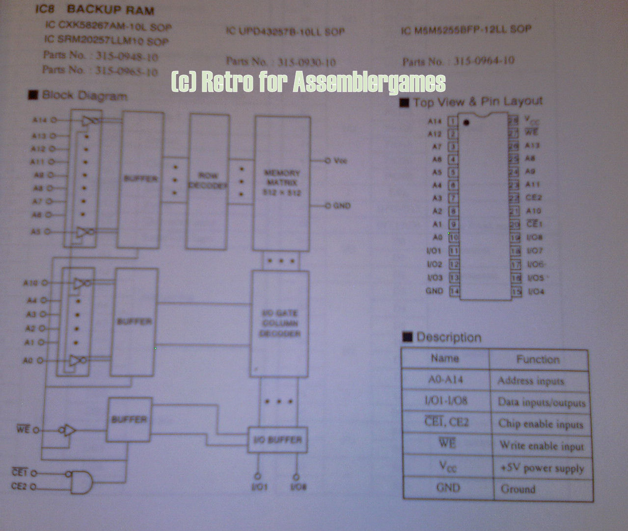

  7. ASSEMbler
    Revised to clarify and I added pictures.
    Here's the pic from the stack, but it's too hard for me to explain. But it's really
    easy to to actually. All you needed was some tin foil and saran wrap, but it doesn't explain well or draw well either so I just killed it.
    Basically you just layer strips.
    Strip to the right
    Battery
    Strip to the left
    saran wrap
    repeat
    Once you're done, just fold all the strips up or down and there you go.
    I see what you're talking about, that old sram is a real hog for power.
    like 500-50 (depending on the chip) mA. I based my calc on the
    current -10microampere SRAM.
    If they used the samsung or toshiba packages, it would be like
    having a pcmcia card on all the time.
    I'll open up a saturn and check what type of chip is in there
    and then look up the specs.
    I've recalculated and made a distinct difference between normal use
    and unplugged storage.
  8. retro
    No luck, I take it?
    I dunno, if at first you don't succeed.... ask he who has the service manual ;)
    Taken from the original model's manual, I believe - err VA0?
