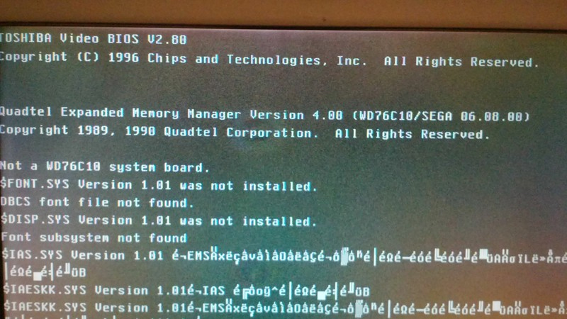

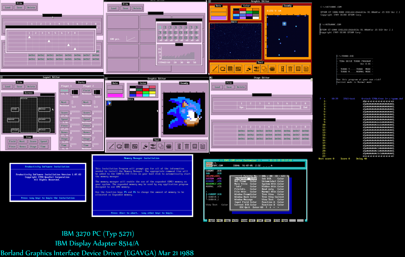

    Below you can see screengrabs of Level, Stage, Graphic and Rule Editor and the Quadtel Memory Manager.
    Loading files via the file browser of the dev-kit(s) is hard, as everything is just black.
    Booting the Kanji DOS V v4 & v5 disks on a Toshiba Satellite 220CS with 120MHz, partly works, but it wont find / install the DBCS font file(s) and the fontsubsytem and still crys for Japanese DOS, even if it already (partly) booted. Probably a BIOS related problem. Ill try again.
    As it is a IBM 3270 PC (Typ 5271), you cant just "flash" its BIOS to any oldskool PC EEPROM.
    I already found emulators of a IBM 3270...they all cost money and Im not sure it will be of any use (yet).

  2. TriMesh
    Jul 3, 2008
    2,324
    WD76C10 is an old system controller chip - I guess it wanted to fiddle with something to get the expanded memory working.
    The (pre DOS/V) Japanese kanji package needed 480 line EGA support - it won't work on a standard 350 line EGA display or on VGA, although I vaguely remember someone patching it to enable it to work with the 640x480x4bpp VGA mode. DOS/V should work on any machine that supports VGA.

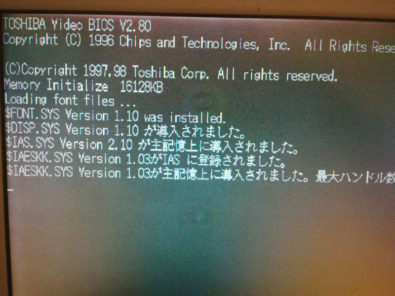

  4. TriMesh
    Jul 3, 2008
    2,324
    I think there are two distinct issues:
    1) The expanded memory manager you're loading was designed to work with that specific system controller chip, and since it can't find it the expanded memory is disabled. Since the font loader loads the data into extended memory, you will have to find an extended memory handler that will work on the hardware you have.
    2) The font driver used that non-standard 480 line EGA mode - so if the video card/monitor can't handle it, it can't set the video controller to the correct display mode, and hence won't load.
    This patch addressed the second issue - it patched the init code to use the VGA 640x480 16 color mode, and also changed the font drawing routines to work with VGA (which, at a hardware level is similar, but not identical, to EGA) - it still needed a compatible expanded memory driver simply because the font data is large.
    If you can find PC DOS5.x/V then it should work without patching on any machine that supports VGA.
    ItsMeMario likes this.

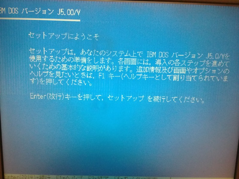

  5. ItsMeMario
    ItsMeMario Gutsy Member
    Feb 11, 2014
    469
    160
    Thank you TriMesh, I have the 5 disk version of PC DOS 5.x/V here. Even MS DOS 6.22 which I didnt know that it existed in japanese.
    I will try the installation of PC DOS 5.x/V as soon as the power adaptor for the VAIO arrives.
    p.s. (I had to try the 1st disk on the Toshiba)
    Already looking good. But I dont want to torture this old fellow anymore. The graphics look strange, as if vertical lines are missing and the Toshiba is my beloved DOS machine already, that I dont want to loose, as it has SB Pro. :)
    Now I can try all the non working exe files from the Tera Drive!
  6. TriMesh
    Jul 3, 2008
    2,324
    It looks like it's putting the video card into a mode which doesn't match the resolution of the panel - ugly, but not likely to harm anything.
    Looking at the first screen, it seems to be loading the display driver and IME correctly, so the hardware must be compatible.

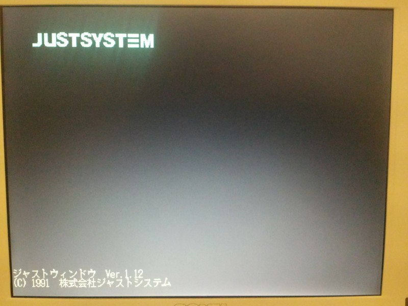

  7. ItsMeMario
    Feb 11, 2014
    469
    160

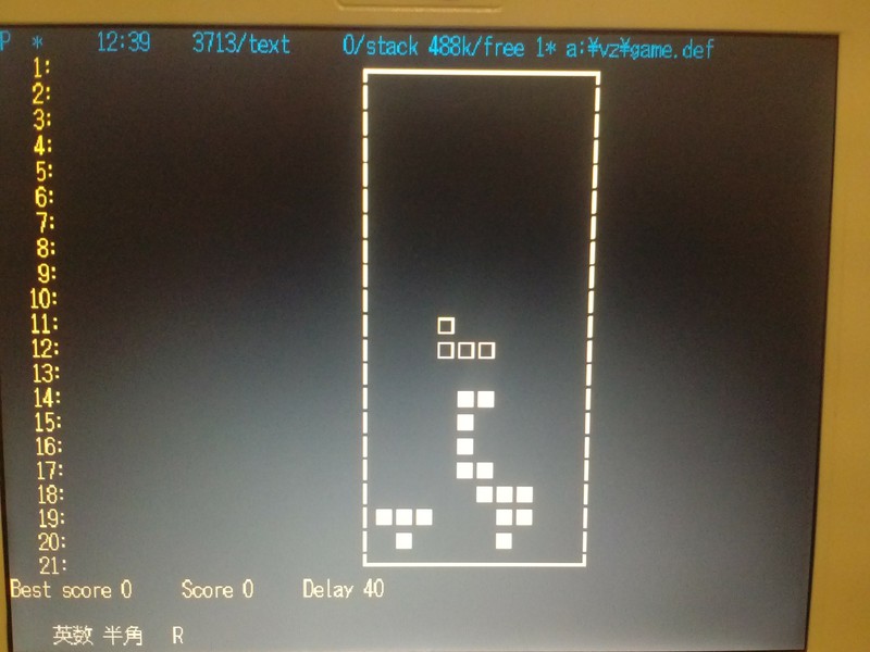

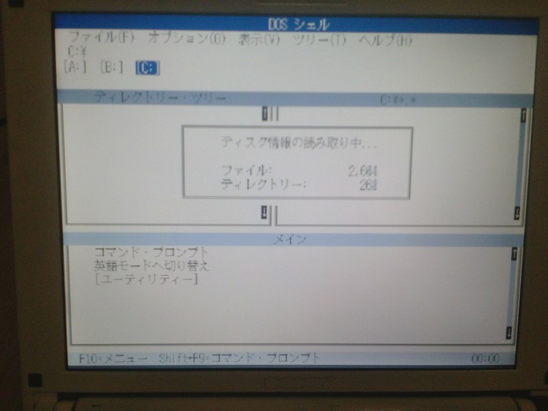

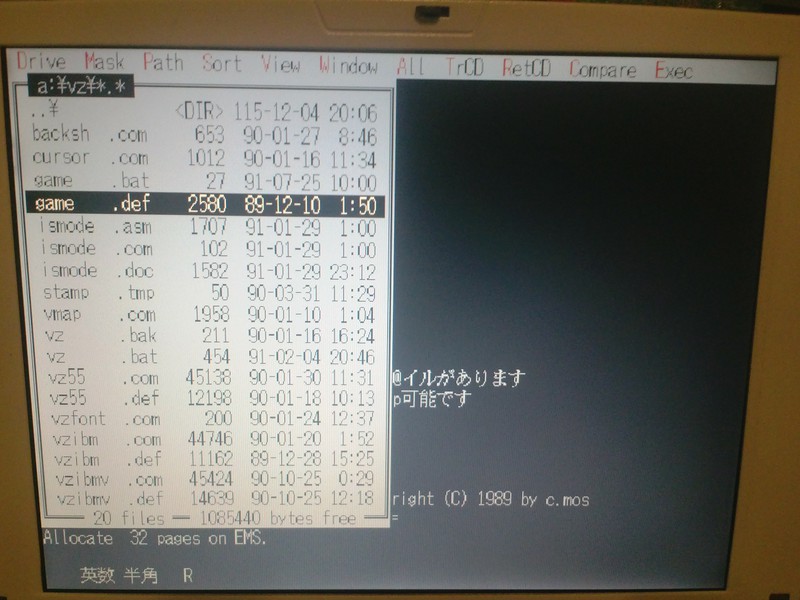

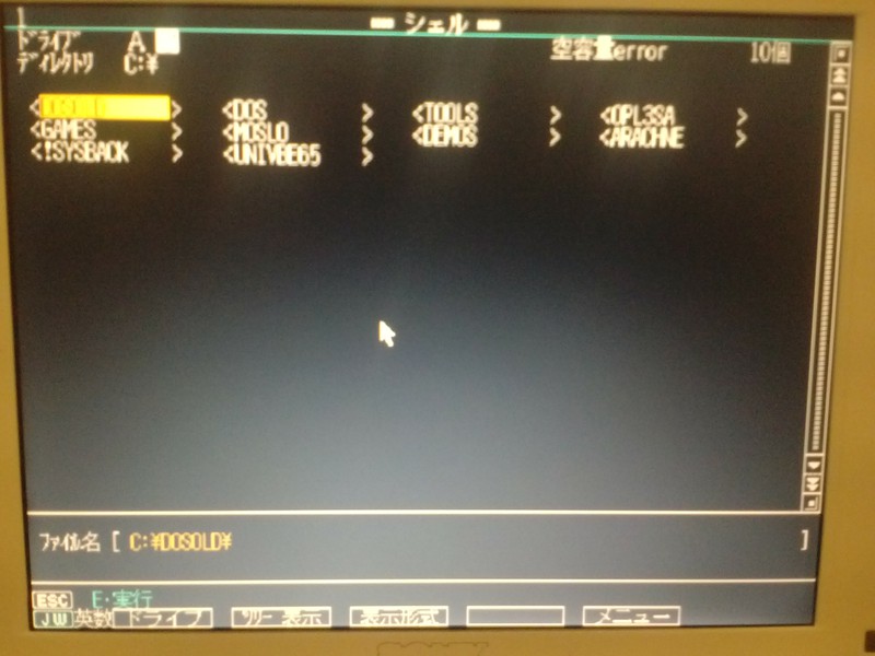

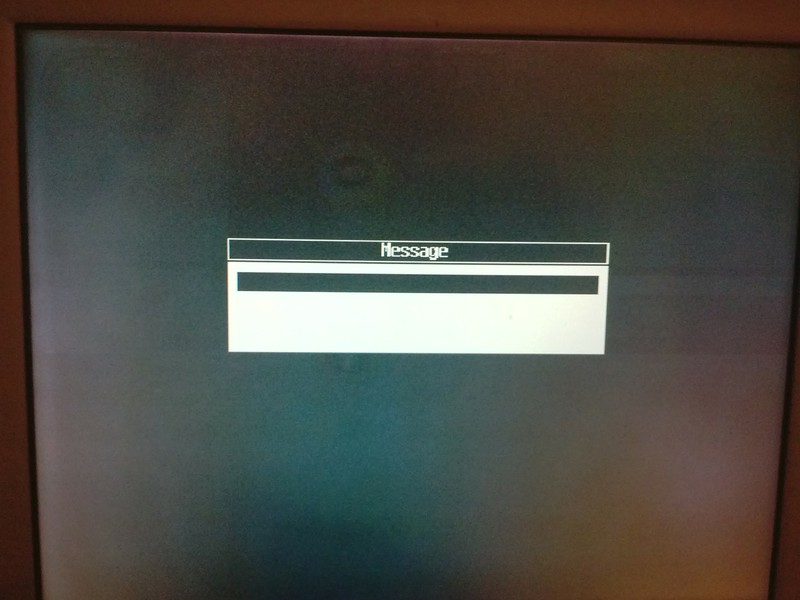

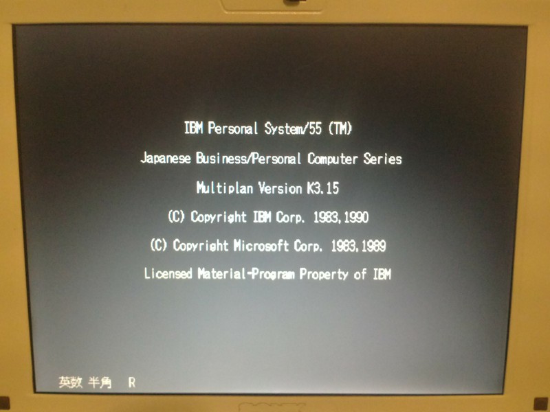

    Ok, 1st quick tests of the applications that asked for japanese DOS :
    After booting : (Shift-F9 exits to command prompt)
    A texteditor, if I googled right :
    Not sure :
    The working Tetris game example, that didnt look correct in DOSBOX :

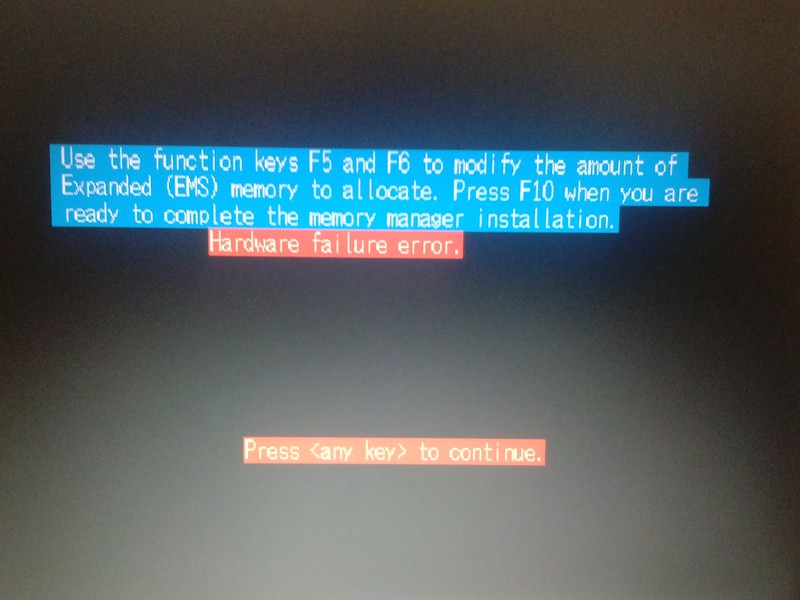

    Memory Manager fails to install :
    IBM Multiplan (later Microsoft Excel):
    Another folder with 4 game exe files will just reboot the laptop.

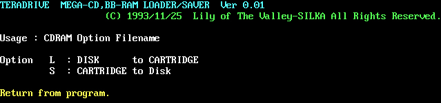

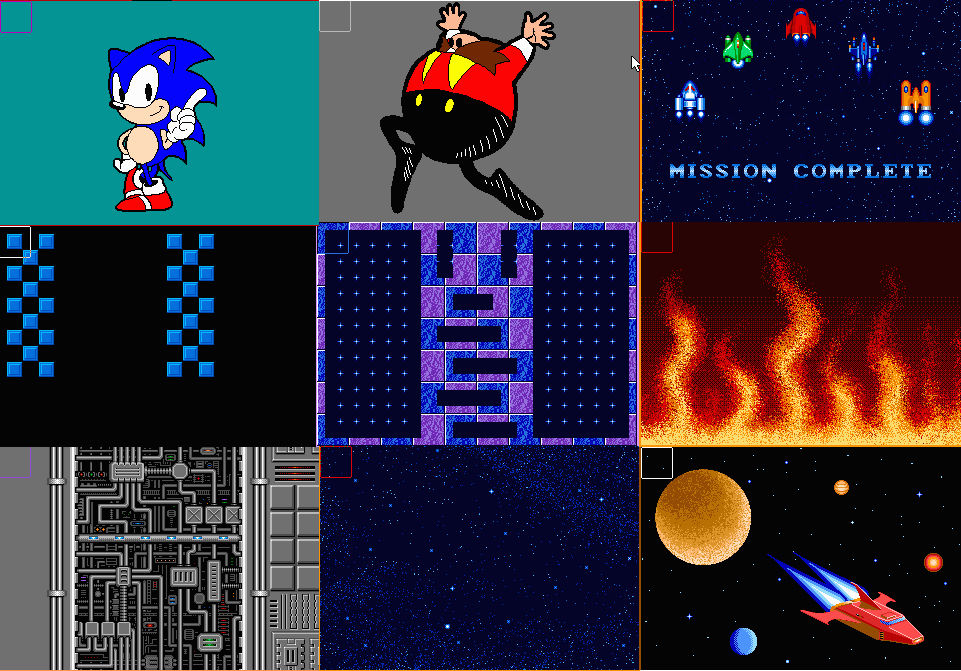

    DOS tool "ScreenThief" is working and I could save some art in its original resolution :
    I also stumbled across the cdram.exe :
    Now I know the CD ROM (Mega CD) never was released for the Teradrive and only 2 prototypes existed according to http://segaretro.org/Teradrive.
    So what about this tool/loader and who would SILKA (Lily of The Valley) be ?
    The exe file says :
    PRODUCED BY OR UNDER LICENSE FROM SEGA ENTERPRISES Ltd

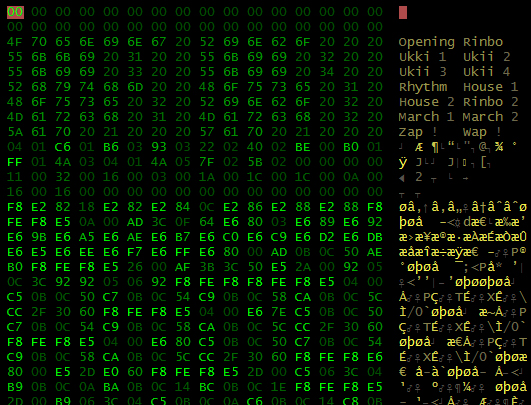

    The music files dont look like the MegaDrive CYM format. The file header starts right with the instruments. Anyone got an idea ?
    There are many many patterns that look and feel like parts of graphics, layouts and / or music...but as mentioned, it is a mess. :)

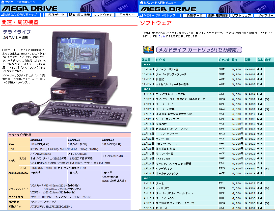

    http://sega.jp/community/segahard/md/tera.html
    Im not sure of the rest as I only did a quick check and I expected to find some sega video when trying to open the link from the discussion (fuzokudx.com) for example, but it was some japanese soft pornographic material. o_O
    A lot of the links are dead or no longer accessible because of robots.txt.

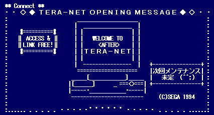

    It seems to be there was a life after TERA-NET called "http://www.after-tera.net/". But you can only find remnants via waybackmachine. Still, very interesting !
    So, this probably was the login page of TERA-NET: :)
