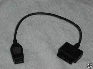

    I've acquired a lead that lets Sega controllers be used on a SNES.
    It's a short black lead with the usual SNES controller plug-in at one end and a Sega 9 pin port at the other.
    For some reason every Sega pad I've tried (Standard Mega Drive, third party, 6 button & Master System pad) doesn't work right - UP on the Sega pad is equivalent to START but that's it. No other buttons do anything.
    Has anyone ever used a lead like this before? I've been told it did used to work.
    Does it need cleaning, if so, what's the best method as the 9 pin Sega end looks fine.
    I've tried the lead on a PAL SNES & NTSC SNES and its the same with both. Can anyone help?
    Thanks!

    SEGA Master System controllers have no chips inside but all the other controllers have logic chips to encode the expanded buttons on the 9 wires the cable has. While a Mega Drive can use a SMS pad, a SMS can't use the Mega Drive because the games on SMS can't set up the pad properly.
    But then you can use the SMS joystick port to read all buttons on the MD controller if you program the port properly.
    An static adapter such as the one the OP described would be "hard wired" for a certain type of controller. Or it's meant to connect an special controller which is based on the same chips as the SNES controller on a SNES.
    Some famiclones do use 9 pin connectors for their controllers but their pinout isn't standard.
    To conclude this, if your lead is a real converter, it HAS to have a box with a circuit board inside. If it's just a cable then there's a possibility it's just a lead for a specialized game controller like maybe an X-Arcade... :thumbsup:

    That's a straight cable.
    SNES pads use serial data so it has a low pin count on their cables. SEGA and ATARI use parallel so all buttons have 1 wire each. MD is slightly different as it multiplexes some buttons to lower wire count on the cable to 9.
    Your SNES is in fact registering ALL buttons pressed at same time because it's just receiving 1 every time you press that button on the pad you connected. Without translation logic it won't work at all.
    So I reiterate. That cable is an adapter cable for something like the X-Arcade pad or something similar like maybe that Capcom fighting pad for SNES.

    I think you are right. At the moment it's pretty useless until I find the right pad/stick to go with it.
