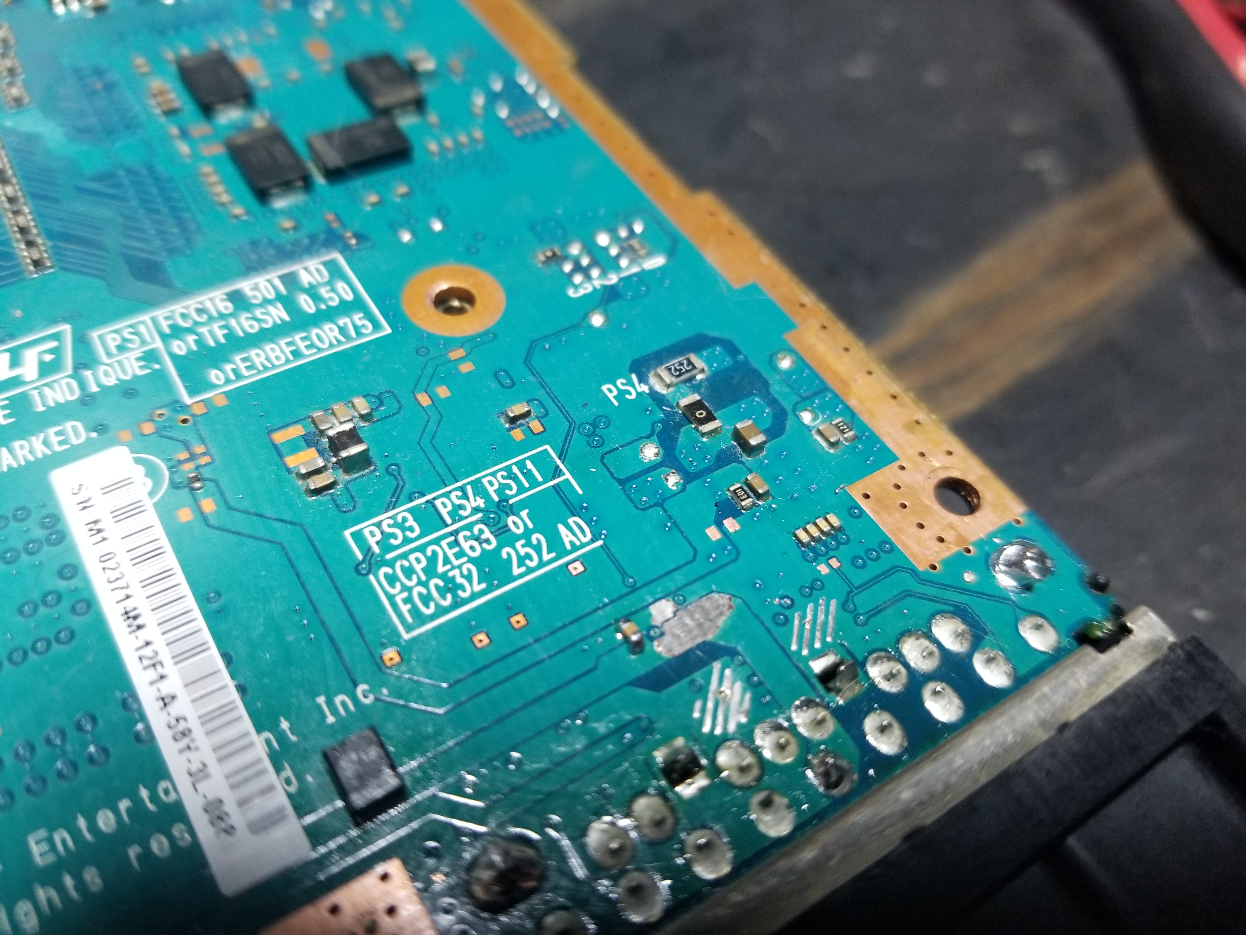

    So today I was modding up this slim Ps2. Last time I touched it I had done a controller led mod. And the soldering was terrible..so I removed my previous work. And while doing so I pulled up some electrical tape that was on the board and it ended up pulling a tiny capacitor with it.

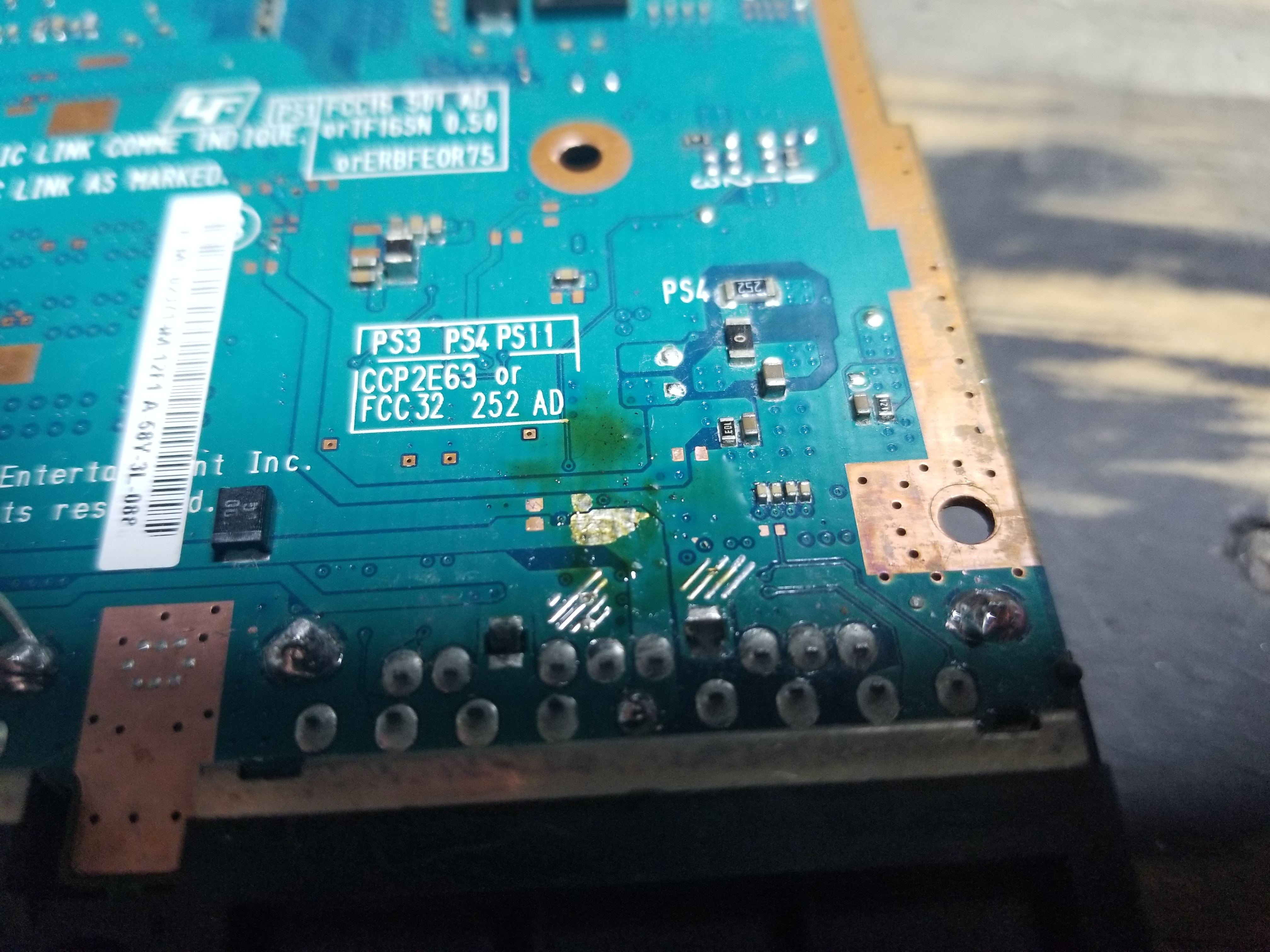

    The capacitor didn't look to damaged so I re soldered it. Ps2 powered on then turned off 2 seconds later. So I removed the capacitor and as you can see the solder and the pads has become a huge blob.

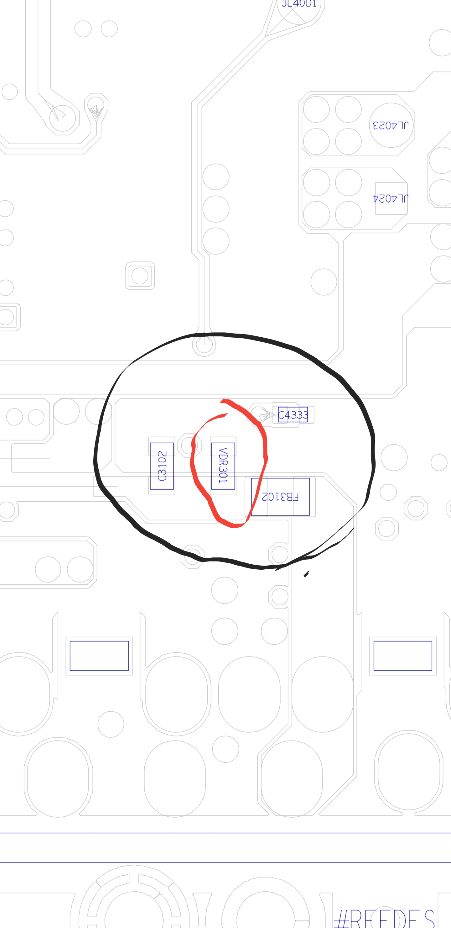

    Now according to the schematic for the 7000 series shows 3 capacitors.. Mine only had the one which I circled in red. The other 2 didn't exist but there was little pads for them .. but those little pads are all one larger pad. I tried braid and liquid Flux but all its doing is making the pad larger... It appears they all connect together anyways (at least the one side so the larger pad should be fine in the end)
    Now I searched for a good picture of the bottom of the board but couldn't find one. I'm trying to figure out if I just need that single capacitor or all 3. Any thoughts? Thanks in advance

    The copper color on the left one reveals there never was anything there in the first place.
    Your gut saying there wasn't anything there is probably correct.

    Yeah it's a ntsc-u, thanks for those pictures! they are definitely different but not alot at least not in the area I'm looking.. All those board seem to be missing the components in question
    Another odd thing is VDR301 doesn't appear on the parts list.. And that code would mean it's a thermistor not a capacitor ... But I'm certain it's a cap based on the color... It's tan versus black.. So if a cap was soldered into the place of the thermistor which is C3102 which is on the parts list
    CAP,SMD,CER 1000PF 10% 50V 1608 X7R
    So I guess I find and order one. Which according to my searches so far 1 will set me back about $7 hmm

    I would clean up the pads and solder the replacement 1nF cap to the pads on the left (the ones marked C3102 on the layout drawing).

    By clean up you mean to use de-solder braid and liquid Flux? Every time I try that it just seems to spread. . almost like the braid is removing the coating of the board. Iv never worked on this board before is the coating really that fragile or is this solder just being a pain?

    What sort of soldering iron are you using? Normally the solder mask is fairly stable unless overheated, in which case it tends to flake off in the way your photo shows. Just make sure that the board is well-cleaned enough that there is no risk of a short and be done with it.
    The other thing is that as far as I can see the console should work even with that cap missing (it's just decoupling), so if it's not working then you likely have some other problem.

    Had a busy day yesterday no time for the Ps2. But I received the replacement capacitors and installed the one that was pretty much the perfect size. Cleaned up the solder the best that was allowed even bought some name brand braid. the mask is definitely flaking.
    Checked the fuse that's ok, and the pads are connected to the ground plane...
    But it's all working now! Controllers both work. Boots up fine left it on for about 10minutes all seems good. I really appreciate the help and advice! 20181109_062059.jpg
