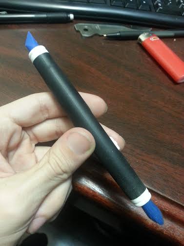

    One of these with a bristle end and a solid rubber end with 97% alcohol and ANYTHING will come off with some effort and it wont damage anything as long as your not plowing your components. I use this for everything from dust to flux buildup and havent had anything i cant clean with it yet. They are just a few bucks on amazon.
    Olschoolgamer likes this.
