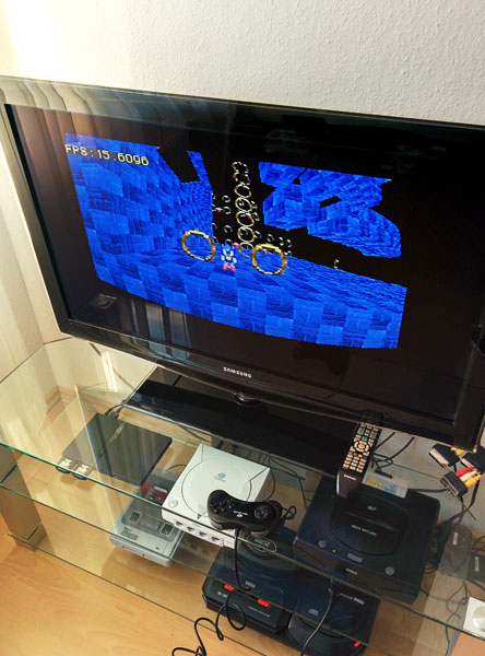

    Quick update: I am still working on the Saturn, tracking down probably the single worst crash bug, which is due to bad timing and the way the Saturn uses display lists and framebuffers.
    In order to speed up the frame rate, the code avoids proper synchronization with the framebuffer, and causes a deadlock due to a data race condition, which freezes the system.
    Using proper synchronization slows down the code a lot, to around 10-12 FPS from 18-20 FPS, so I am looking to see if there is a workaround that I can use to avoid the race condition, while still allowing the code to run only slightly behind the VDP1.
    This is going to take some time, but after this things should get better.
    Jolly

    Some more news: finally I got the sync code working properly, the engine now doesn't crash trying to force the VDP1 to draw while the framebuffer is changing without proper management of the end of write flags in the vblank interrupt.
    I actually changed the code to not use the VBE erase/draw pass in the vblank, as from my tests I remember it was more beneficial to use a large polygon to clear the screen instead, and it makes the code less dependent on synchronization with the vblank, which in turn frees up some CPU cycles to do some work.
    I also tried to do a full double buffer overlap between the VDP1 drawing and the CPU writing the new display list, but it was a naive attempt, as the code is really not written to access memory properly and in the end it made the frame rate actually slower due to contention between CPU and VDP for access to the framebuffer SDRAM.
    With that largely out of the way, I fixed another giant issue in the polygon camera projection code, which did not perform any clipping whatsoever. For now the fix is just to identify troublesome polygons (exceeding the VDP1 coordinates region) and not draw them, eventually I will write a proper clipping fix.
    The engine now seems to be relatively robust, using a very basic level it doesn't crash all the time, I can actually move Sonic around the level (slowly at times due to frame rate).
    Depending on the amount of polygons and their size, the frame rate varies between 10 and 25 FPS, even 30 when the screen is mostly blank.
    The way the rendering engine is written performs very poorly on the Saturn, which needs to overlap as much as possible CPU work with the VDP1, so eventually we will have make some pretty radical changes to speed it up.
    Finally I can now resume working with Andrew75 on loading more complex levels, but first I would like to try to make a very simple "as-is" release, similarly to what we did for v37.
    After the work on loading other levels I will get to profiling which parts of the code suffer the most and start tuning.
    Stay tuned...
    Jolly

    So, we released a first "as-is" Saturn version of the v40 engine, I hope you enjoy it, much more to come...
    Jolly
  19. z3ntn3l
    z3ntn3l 16 Bit Superstar
    May 11, 2005
    128
    Works on my PAL Saturn just like you described it. Thank you very much!
