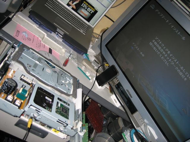

    there is only one chance when PSX on system software upgrade time , swap another sony HDD, let it install new file on there.

    We recently found out that the PSX HDD is encrypted. And it might be encrypted with keys which are unique per unit.
    Since HI_Ricky had such a useful test and prove it's possible to swap the harddrive through a update disc, it could be possible that the unit just require SONY harddrives and has no binding at all.
