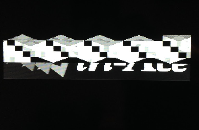

    I start the game on the affected Snes, Enix logo comes up as it should, then the Tri-Ace then I get this (see attached image) and no sound. The game freezes on that screen.

    EDIT: I forgot to mention that the affected Snes can play any other game I throw on it, and never had any problems with it so far. Been playing Super Mario RPG on it, Yoshi's Island 2. I tried with both SCART and Composite cables too

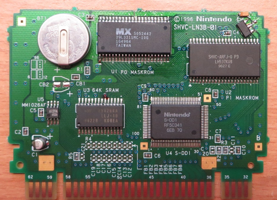

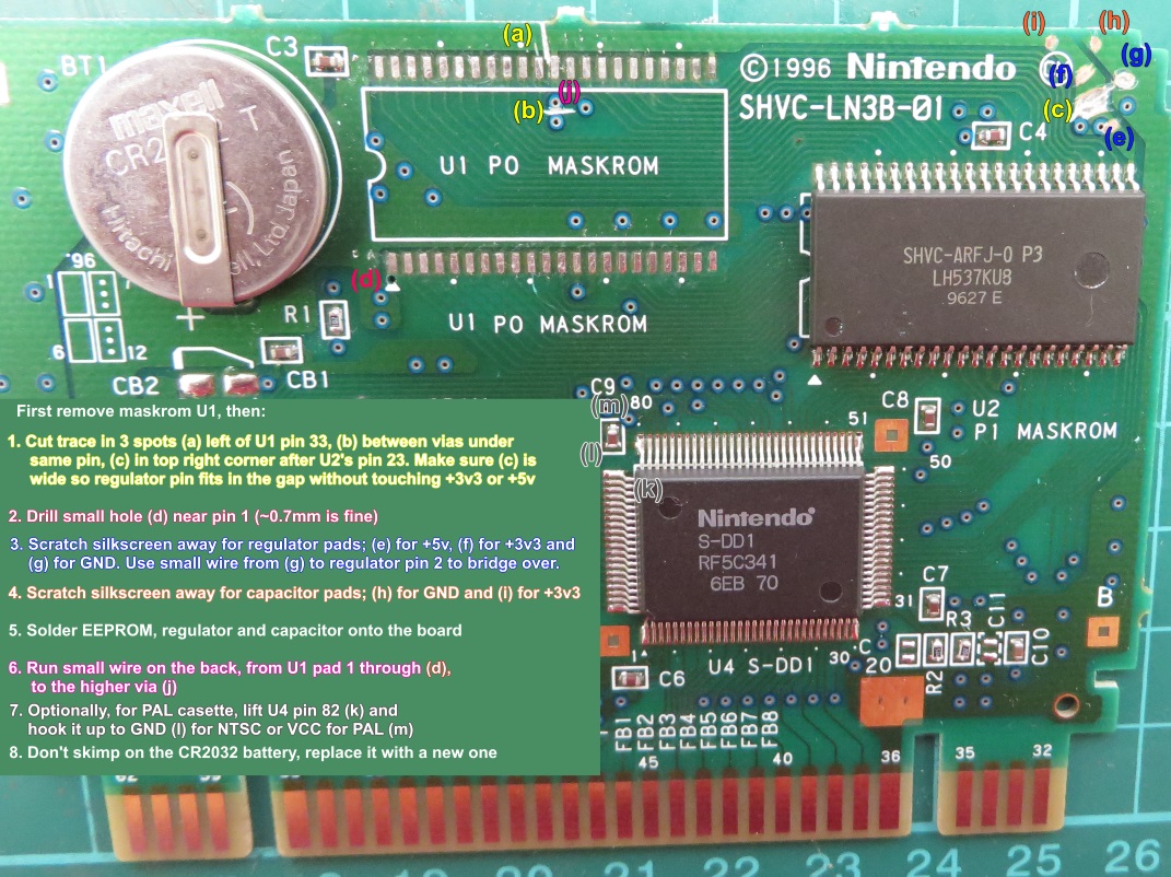

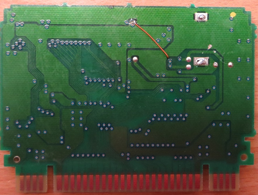

    http://www.mmmonkey.co.uk/star-ocean-translated-cart/
    zzattack yes, I was following the guide above
