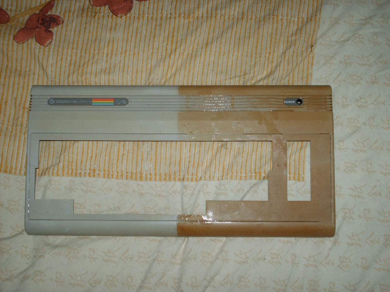

    I'm just gonna jump in here and point you in the direction of the guys over at English Amiga Boards.. They've been investigating a solution for the oxidisation of plastics, and have even got an industrial chemist (!) among thier ranks.
    Long story short..
    Problem: Oxidisation of Bromine in plastics causes discolouration.
    Solution: Removal of oxygen from bromine. Use Hydrogen Peroxide solution to replace the oxygen with hydrogen - restoring plastic to its original composition.
    Very interesting reading here..
    http://eab.abime.net/showthread.php?t=37808&page=6
    and here..
    http://eab.abime.net/showthread.php?p=458725#post458725
    Look out for the posts by Merlin, tonyyeb and ZetrO.
    And a wee piccy results they are achieving.. (I'm sure they won't mind the direct link)

    in any case the case with the snes is different since the yellowing in that case it's on THE SURFACE while on the snes case IT'S ON THE WHOLE PLASTIC BODY (parts not exposed to the light too and the plastic's inside too).
    that means that if you use h2O2 on a yellowed snes the results won't be the same. still worth a try tought :)

    Ok, we had a forum member at gamescollection.it who tried with a 36% solution on a yellowed SNES for hours. No results.
    He think that it may be due to the fact that old computers are made of ABS 7801 and the SNES of PST 7801.
    So, no results at all.
