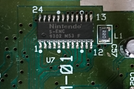

    Mine is a S-ENC 9302 (pic).
    I'll try finding another encoder and regulator as suggested. Thank you all for the help, it keeps me from giving up on this :)
