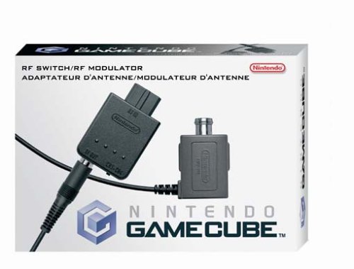

  14. retro
    Sorry, don't know what comes with a GameCube as standard in the US! Which of these?
  15. turbocozmo
    turbocozmo Guest
    It looks like that.
  16. retro
    That's composite.
    As Kyuusaku said, that sounds like an internal fault.
    Video is handled by chip U7, a BA6592 RGB processor. Of course, there are components between this and the AV connector, so take your pick as to what's faulty!
