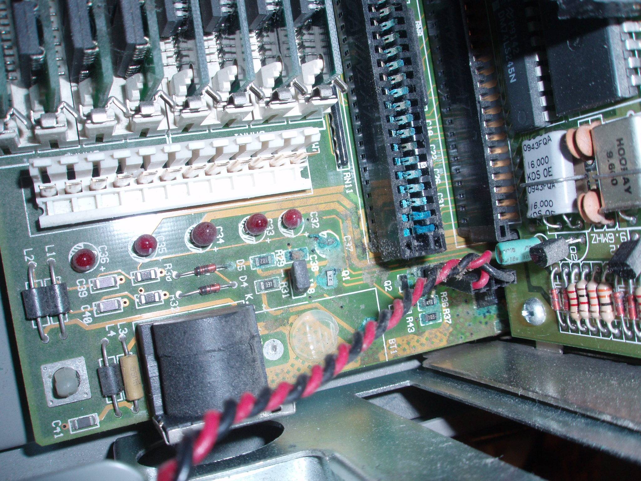

    Anyway I only ever used sandpaper twice on connectors, and it was on some damn serious cases. One time was the sega mentioned earlier, other time was on a 486 PC board that suffered battery leakage. I took a photo from the PC board, so I can show you how bad it actually was, and the Genesis was close to that bad.
    Believe me or not i actually got cards to work in the slot later on.
