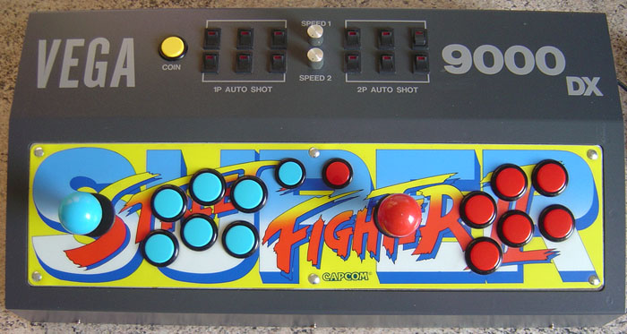

    1. Vega 9000DX
    http://www.videogameimports.com/images/pictures/Vega9000DX_July24_2006.jpg
    £299.99 + £7.50 Delivery Charge

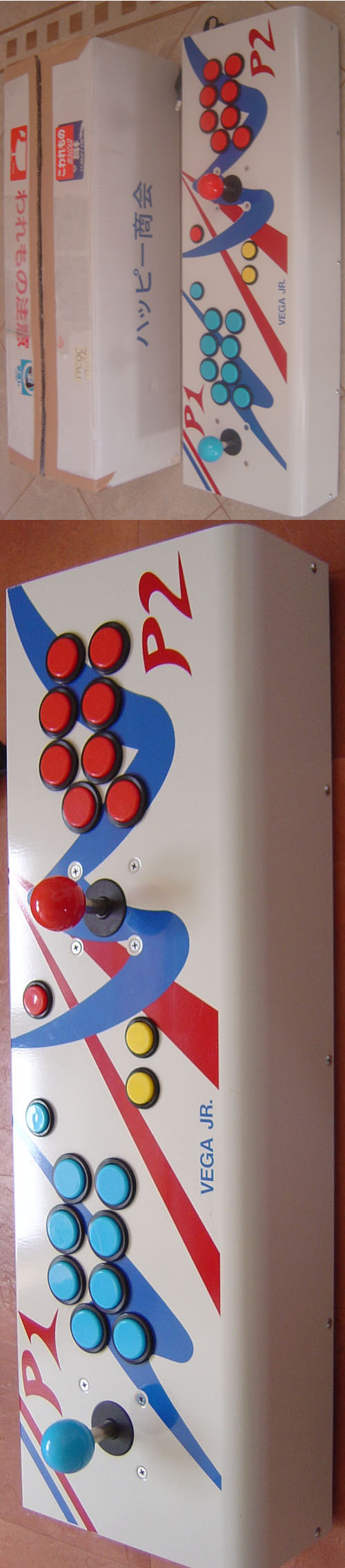

    2. Vega Jr.
    http://www.videogameimports.com/images/pictures/Supergun_VegaJr_30Mar2007_MINT.jpg
    £329.00 + £7.50 Delivery Charge

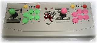

    3. Sigma Raijin
    http://www.retrogame-shop.com/shop/images/raijin.jpg
    £260.00 Delivered (With RGB Cable)

    There is an arcade forum on the boards too, not that it'll help much. The Sigma Raijin is a nice piece of kit, it's just it's about £130 in Japan.

    Shipping of a Sigma AV7000 + 9000TB to the UK is about 50 GBP (I've sent a few). I have a used Sigma AV7000 + 2 9000TB sticks for sale if you want to take a crack at them. It is a great gun. Personally, I wouldn't bother w/ the Raijin... I can't stand having people that close to me.
    They also come w/ the video & contoller pinouts in the case that you want need to make an RGB cable or another controller.
    If you have your heart set on the Raijin, I can probably get you a new one for close to 200GBP after EMS shipping & my commission. Comes w/ a Jamma harness, but you'd have to make your own RGB cable.

    I do like the sound of the Raijin due to the fact that it emulates the positioning of a real arcade machine..

    As a note the Vega is basically no longer made or sold in Japan. The shop that sells the Sigma AV7000 and Raijin is Mak Japan.
