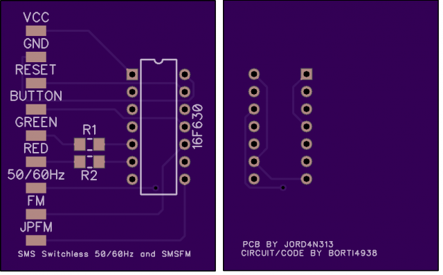

    I know it isn't really necessary and I could just wire directly from the chip, but I prefer the clean professional look of a proper pcb to a loose chip and resistors - so I made this PCB for Borti's design. It is not much, but it was just as much about learning how to design a PCB as it was about modding my Sega Master System. What do you all think? If there is any interest, I'll upload the Gerbers, and since Oshpark is making me order 3 pcbs as the minimum, if anyone is interested in one of these boards, I don't mind putting together the other two and sending them out for just the cost of the materials and shipping OR I can send off just the blank board if you cover shipping - these 2 extra will go to waste otherwise. I can't do much, but I'd like to give back whereever I can as a way to pass on the selfless contributions of giants like Borti who designed this whole switching system!
