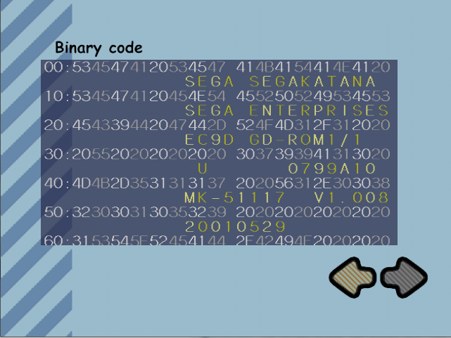

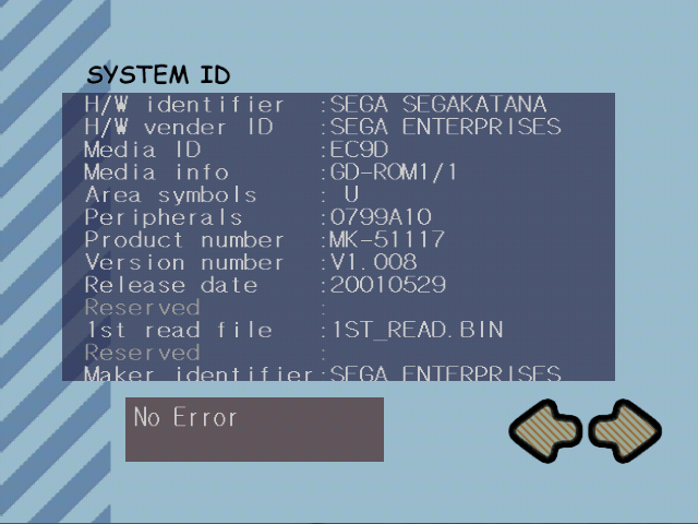

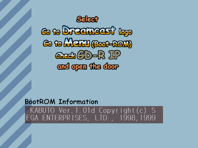

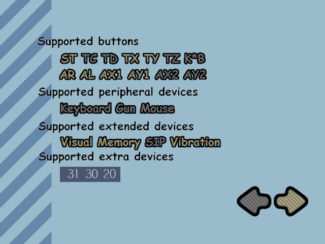

    Hi. can't find information about this secret anywhere so posting here...
    Normally this disk boots to screen with single "Complete" word and waiting for disk change.
    but if plug controller into port D and hold Y button while booting you'll get this:
    which gives few more options. last option validate inserted disk and provide various information:

    agree, I can only imagine it may be useful as an IP.BIN viewer - boot from SD2, insert some GD-R(s) and check if their's texts/dates match final games or already dumped prototypes (at "SYSTEM ID" and "Binary code" screens you may press up/down to scroll and view more information).

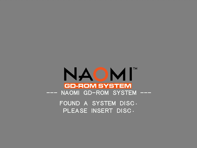

    there is also one more, mostly unknown, usage of SD2 - for NAOMI 1/2 GD-R booting. if insert System Disc 2 into NAOMI GD-drive you'll see screen like this:
    then you may change disc to some NAOMI-GD game written on GD-R and it will be run.

    127
    @fafadou NAOMI games was ROM cartridges, then DIMM board (kind of RAM cartridge with GD-drive) + games on GD-ROMs. and later, in ~mid 2000s, when GD-ROM manufacture was closed Sega switched back to flash ROM cartridge media.
    during game development for NAOMI + DIMM/GD-ROM system, at it's final stage developers must be sure GD disc image was built right and works ok, before submitting it to mass manufacture at least.
    and System Disc 2 (together with some code in DIMM firmware) provide such possibility - devs burn game to GD-R disc and then boot it using SD2 to check if everything works as it should.
