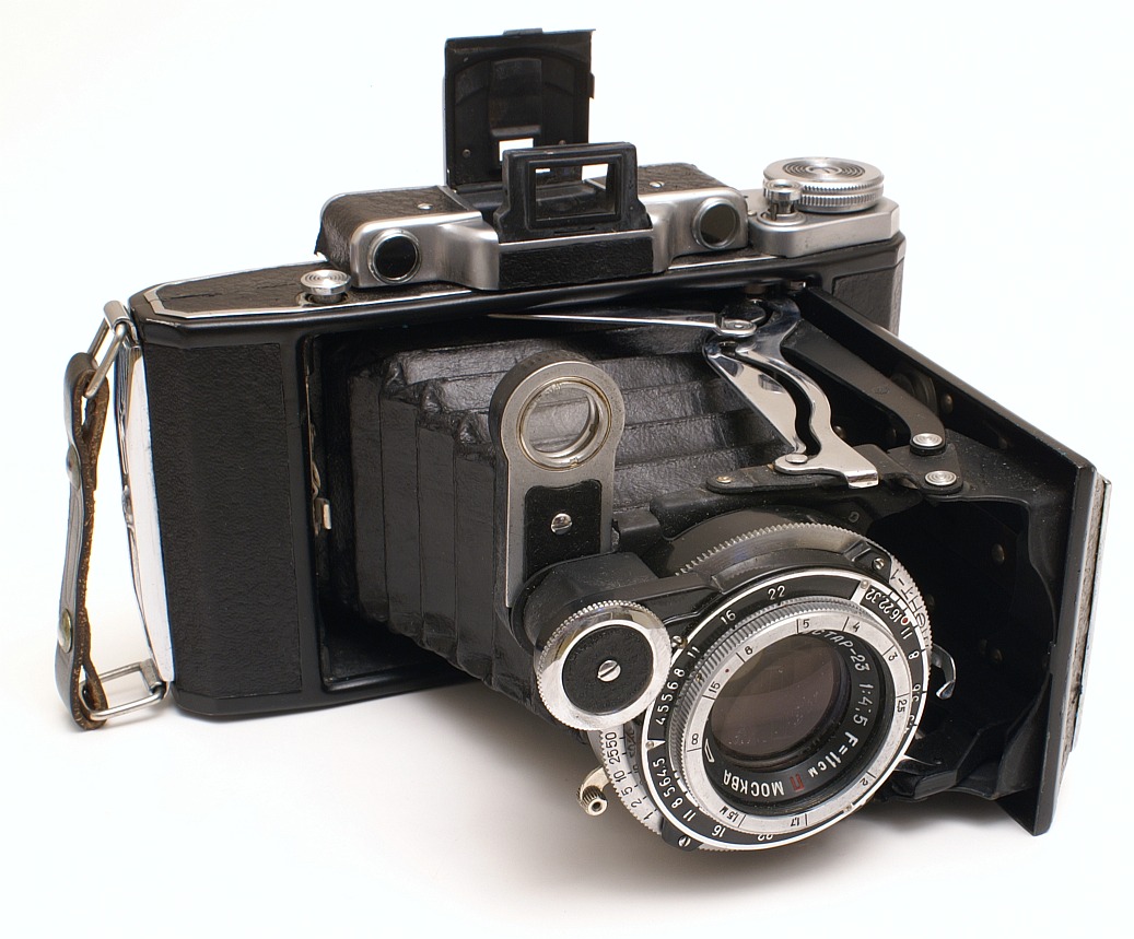

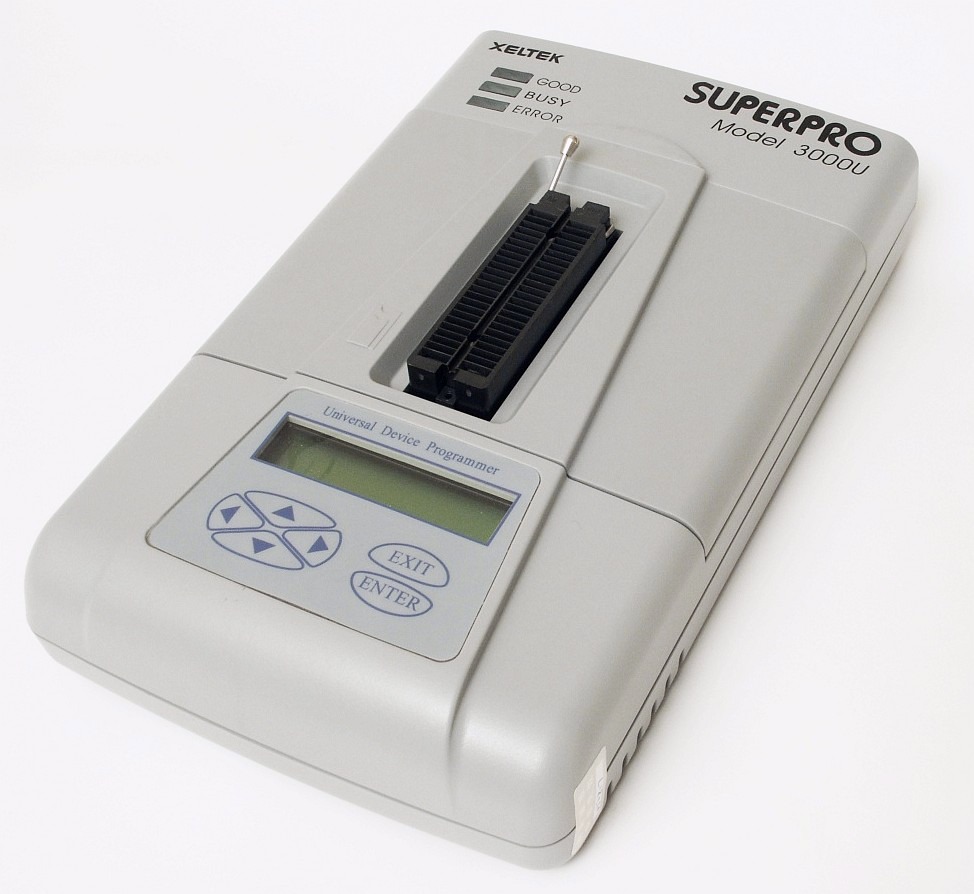

Right here's Tachi's "Two Minute Ghetto Studio Tutorial" So, you want to take photo's like this on a budget: Yeah I know, it's not that good, but it's a 2 minute tutorial, you can fiddle and tweak in photoshop later! What you need: Camera with hotshoe (for a flashgun) Any old P.O.S flashgun that works with your camera (check trigger voltages!) that is poseable Roll of plain, white wallpaper Piece of white card/foam Rubber band First, setup your "studio" by hanging a length of the wallpaper over something high (I used my monitor) allowing a gentle curve in the paper to reduce shadows Stick your subject on the paper, roughly central, position best to reduce shadows from the existing lighting Cut the card/foam for the flashgun according to: http://abetterbouncecard.com/ Attach it to your flashgun Take photo's in manual mode (RAW if you can) adjusting settings and the position of the flashgun) so you get the right light at the right angle. You can paint out what shadows are left in photoshop if you really want a pro look. Total price (excluding camera and flashgun) £4 You can see in the phone photo the shadows from the lighting in the room without using the diffused flash, and see what the diffused flash does in the proper photo's

one question; you'll be only taking pictures of static items? also consider that thos lighthouses might be small for some of your needs. I have some experience in the field and i suggest you tachikoma's way. Also i suggest you to start taking some pictures before going on with expensive equipment. If you have enough space using 2 connected flashes, with light diffusors is a FAR cheaper and effective solution.
Looks alright, but you can do the same thing with two desk lamps and the aforementioned roll of wallpaper, but it depends if you want to save money and piss around with setting it up yourself or just take the photo's and be done with it.
