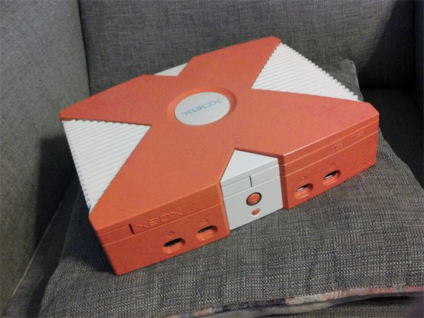

    When I paint xboxes, and I've done a few, I take the shell completely apart. Then I wash the shells, let them air dry completely then spray them with several very light coats of bright white krylon fusion. After that dries completely I do several very light coats of the colors I want. I think the technique matters more than the paint. If a person does several light coats with a rattle can it will look better than somebody airbrushing automotive paint on so heavily that it starts to run. Below is one of my xboxes. I'm happy with the result. It's hard to tell with my cellphone camera, but the finish is smooth and not textured or orange-peely.
    I know the flaws with my approach, but I'm happy with the results. To each their own.
