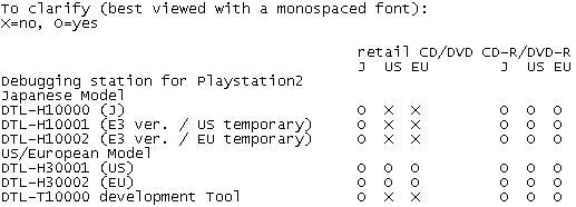

    Just got my test: DTL-H10000 that plays all retail Japanese ps2 games, and that's pretty much it. Doesn't play retail American ps1 games, they're recognized but just goes to a black screen when booted. Don't have Japanese ps1 games to try out. The only ps1 game that started fine is my net yaroze boot disk for some reason, and even it has more scratches than the ps1 games I tried. Haven't tried any backups.

    I'm very inclined to believe that only Japanese PS1 titles will boot on a PCMCIA Debugstation. Why ? Because the retail counterpart has "hard locks" on the BIOS (PS1 Driver) for keeping discs with non Japanese boot sectors from loading. And the Debugstation BIOS is usually based on the retail counterpart model. :shrug:

    I think the TEST consoles do have disc region checks, because (to my knowledge) they do not play copies of retail games as-is. However, the disc is considered "fine" if it has ANY region info; unlike retail machines, which need the disc to have region info matching the respective target region.
    The other main difference is that the region detection of TEST mechacons can be overridden by placing a "license file" into the disc's system area. If such a license file is present, the TEST mechacon treats the disc as an original for the corresponding region. Retail mechacons just ignore such license files.

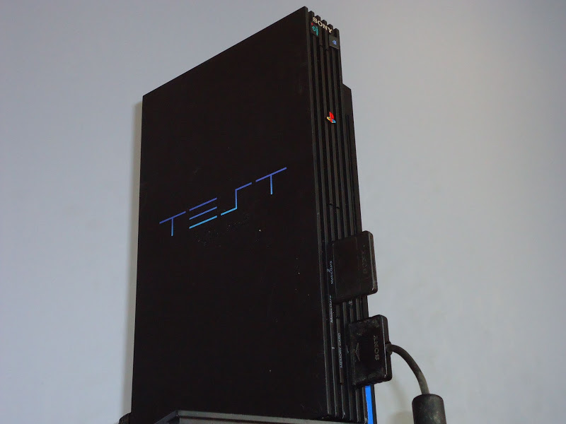

    Sorry if this isn't the correct place to post this - I have a Playstation Two test console, specifically the DTL - H30000 E. According to this thread, this console was intended for Korea only but the 'E' at the end of the model no. indicates that this model was for use in Europe? Externally it has 'TEST' in blue letters above the 'PlayStation 2' title.
    I tested it a while ago and it can play PS1 PAL (do not own other regions) and PS2 PAL +NTSC (do not own other regions) I also recall it playing both UK DVDs and North American.
    Output is AC 220-240V and next to the serial number it says: NTSC J
    Any information about this console would be greatly appreciated, thanks!

    It's a japanese model for use in Europe.
