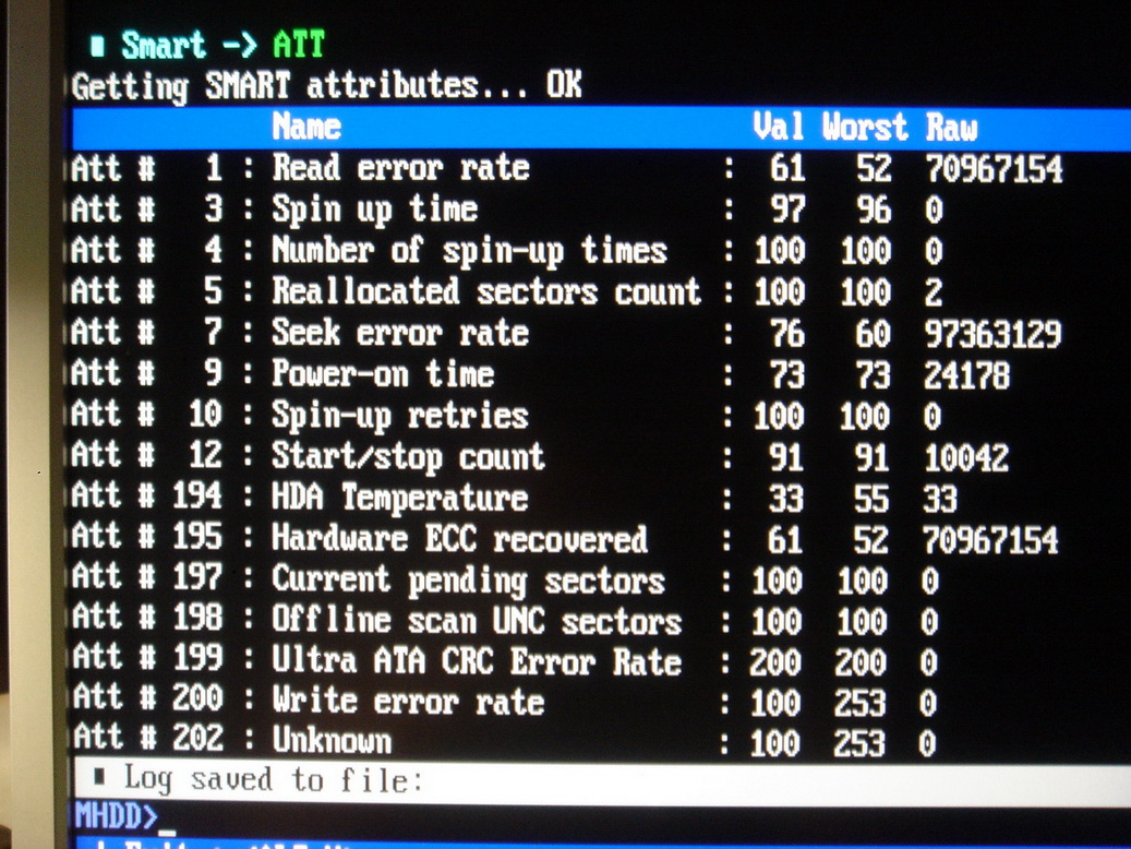

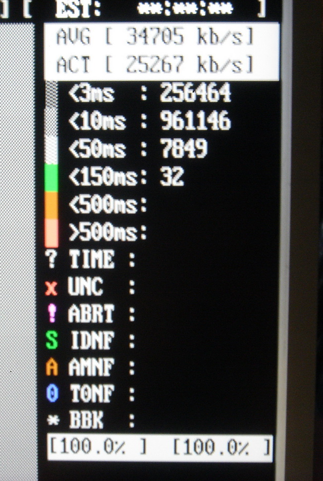

    Here are simplified SMART HDD my DESR-5000. In principle, is normal for the device, which is 12-13 years. "Reallocated sectors count - 2" - certainly bad, but nothing wrong with that, given that in recent years they have not been added. (Most likely, the previous owner had power problems.).
    In general, the whole will sooner or later come to an end ...
