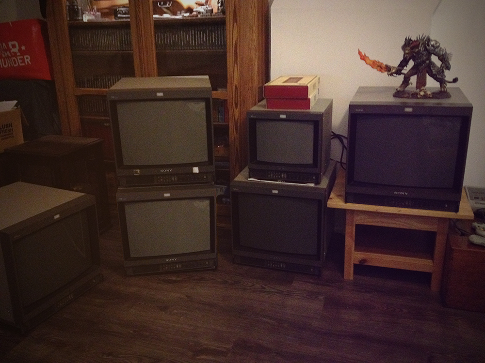

  13. Morn
    Morn Rapidly Rising Member
    Jun 11, 2014
    81
    Oops, what did I buy.
