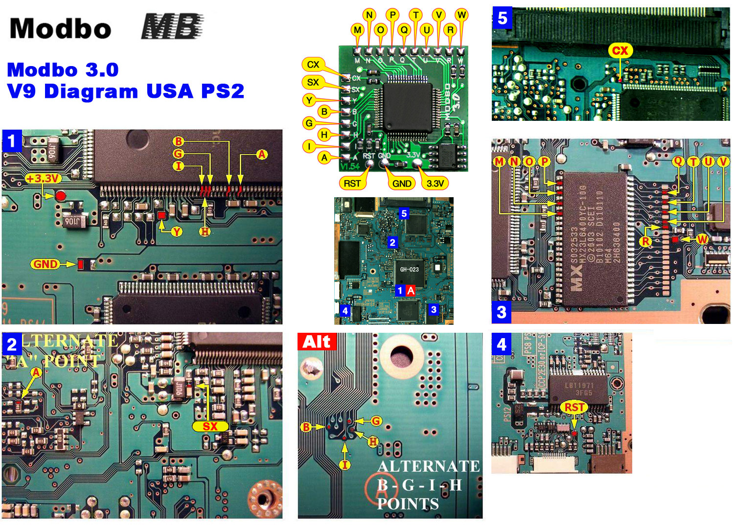

    As to installing it, my PS2 is a PAL (Australian) SCPH-50002, from what I've read, it has a V9 motherboard, so is this the diagram I should be following?
    It says "USA" on the diagram, so is installation different for my PAL console? Also, I see there's some alternative solder locations for the wires that are normally soldered to the legs. This sounds appealing to me, since soldering to the legs sounds really fiddly, and there seems like there would be a strong likelihood of accidental bridging, but is there a downside to soldering to the alternative locations?

    Looks like the Modbo3.0 installation is more difficult than the 4.0. Don't recall the v9 requiring soldering to the legs of that IC.
