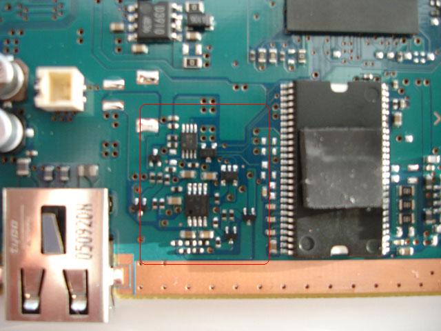

    Talking about the PS2 blowing the laser tracking coils when modded, can anyone confirm that Sony added a circuit to the v13 pictured below that protects the tracking coils. Something to do with the fact that the tracking coils would blow on the v12 regardless of if it was modded or not. If so then then would this extra circuit also protect the coils on a modded console or is my v13 with DMS Pro SE and no laser fix just an accident waiting to happen?
  17. Bad_Ad84
    1,311
    V9-12 are affected models, V13 is not.
  18. kel
    kel Spirited Member
    Aug 13, 2012
    103
    Then why is fireaza going to so much trouble to find a v4 or below when only v9-v12 are affected models or am I missing something?
