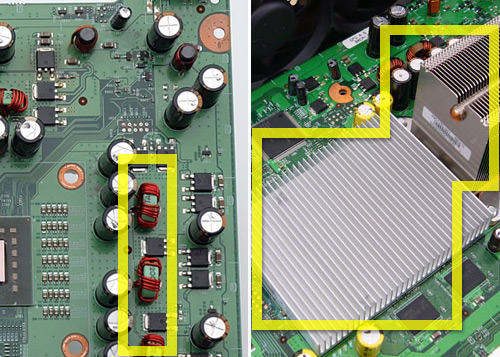

    to make sure see which of these looks like your motherboard.
    Xenon
    Opus

    OK, it is a Xenon - I wouldn't have thought they would still be using those boards in mid 2009, but apparently they were. It does have the Zephyr style additional GPU heatsink on it, though.
    Looking at the board, it appears to have been refurbed - some of the parts have much older date codes and there is sticker residue from the old barcode sticker. But with that date I assume it's got the new JTAG resistant bootloader...
