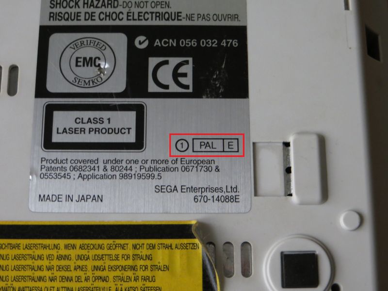

    I have a Asian Dreamcast HKT-3010, would the GDEmu be compatible with asian/ japanese Dreamcast?
    Many thanks
  20. Anthony817
    Anthony817 Familiar Face
    May 12, 2010
    1,078
    535
    It has to be a VA1 revision. VA0 and VA2 are not supported. So as long as it shows a circle with a 1 inside it on the bottom of the console it will work.
    So for instance on a PAL version it would look like this.
    Same thing with any NTSC consoles as well. As long as it has a 1 inside the circle you are good to go.
