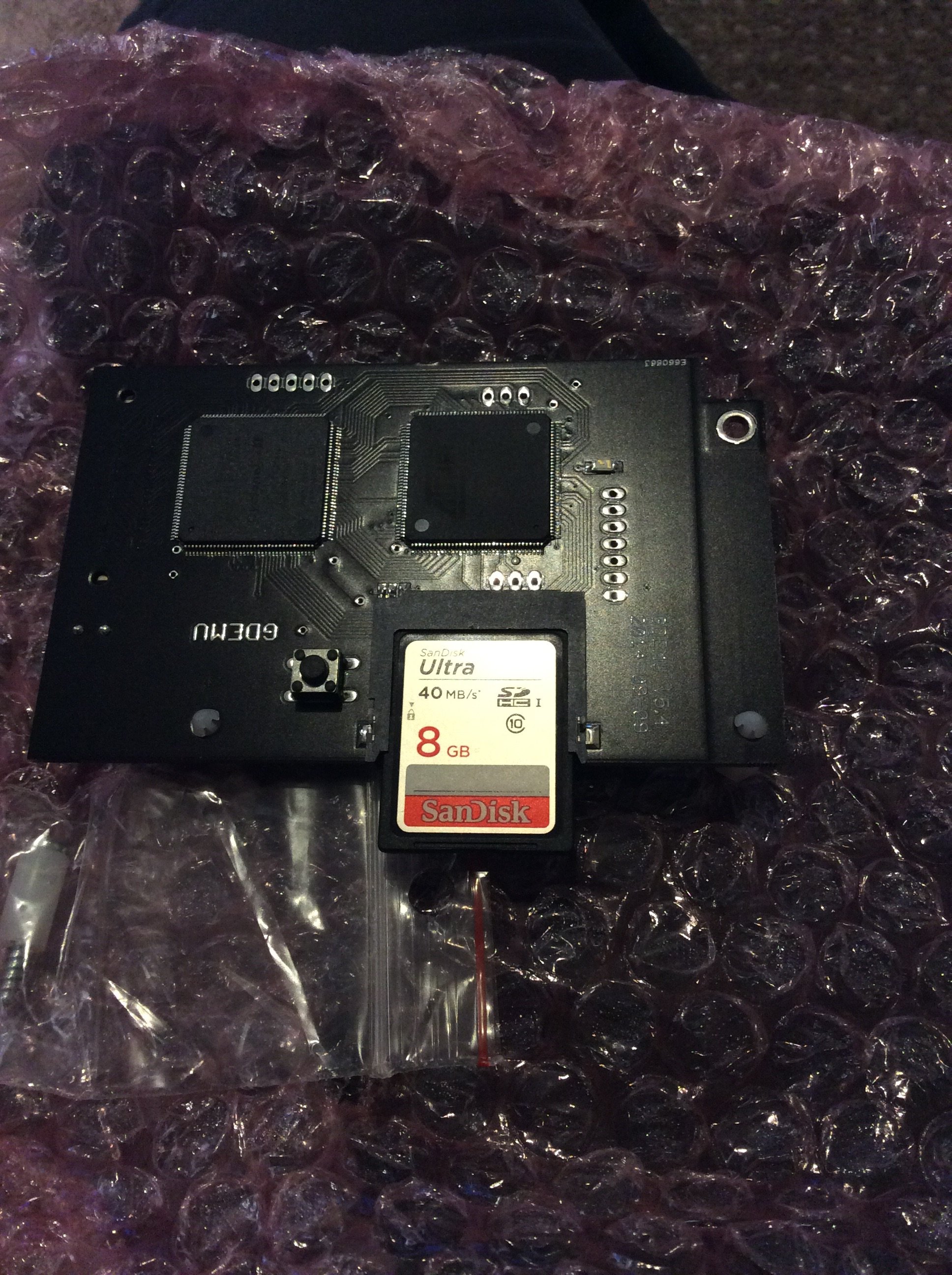

    Could you change the yellow txt to a light grey? As I use the classic colour scheme & you can't read it.
    (Please)
    As for a sd card, I have an Sandisc Ultra Class 10 8GB.

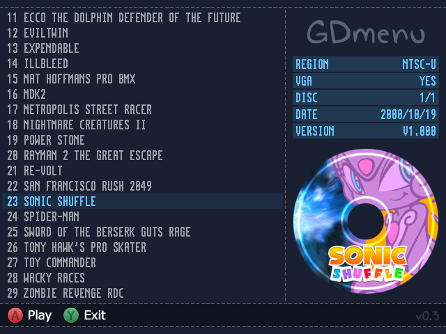

    Hi,
    I dont know if anyone else has had this issue, with GDEmu + GDMenu (v0.52)
    I can load the GDMenu and it shows 2 games in the folders 02 and 03
    but selecting either of them, it shows the DC logo anim and then reloads the GDMenu.
    It will load either of the games fine if they are in the 01 folder, but I cant get the
    menu to load any game.
    I suspect it maybe my GDEmu Firmware version, I have upgraded it to the latest version
    on Deunans site, but I'm wondering if this has never worked, and its still on the original
    shipped FW...
    Is there a way to be sure that its running the latest version?
    or any other ideas what could be wrong (assuming it might not be the FW)
    thanks
