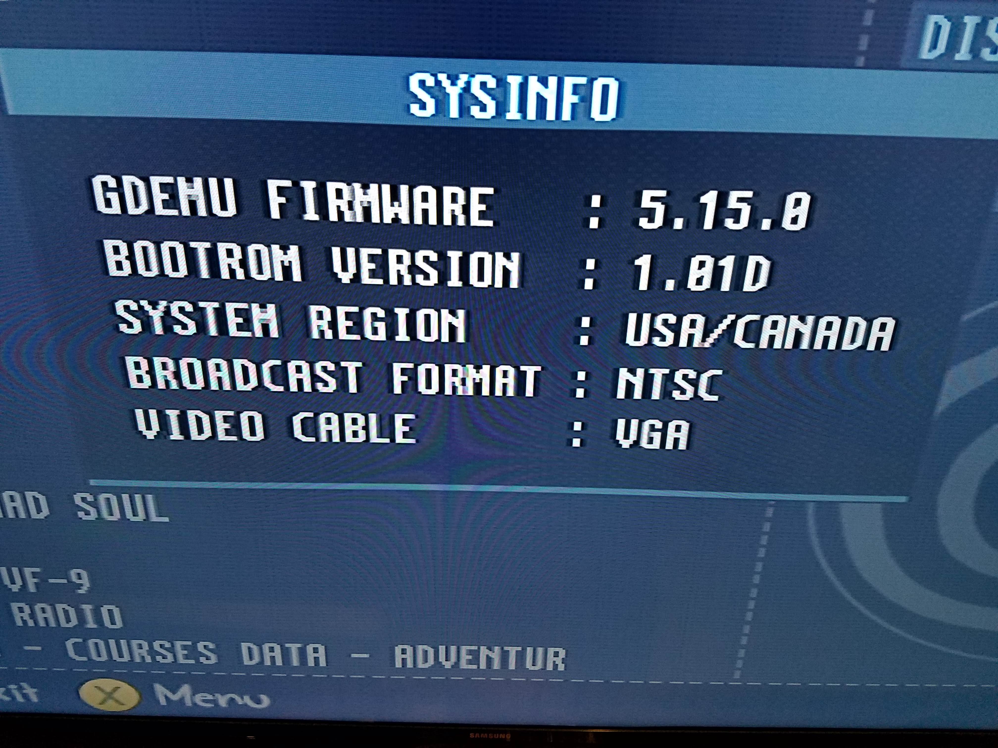

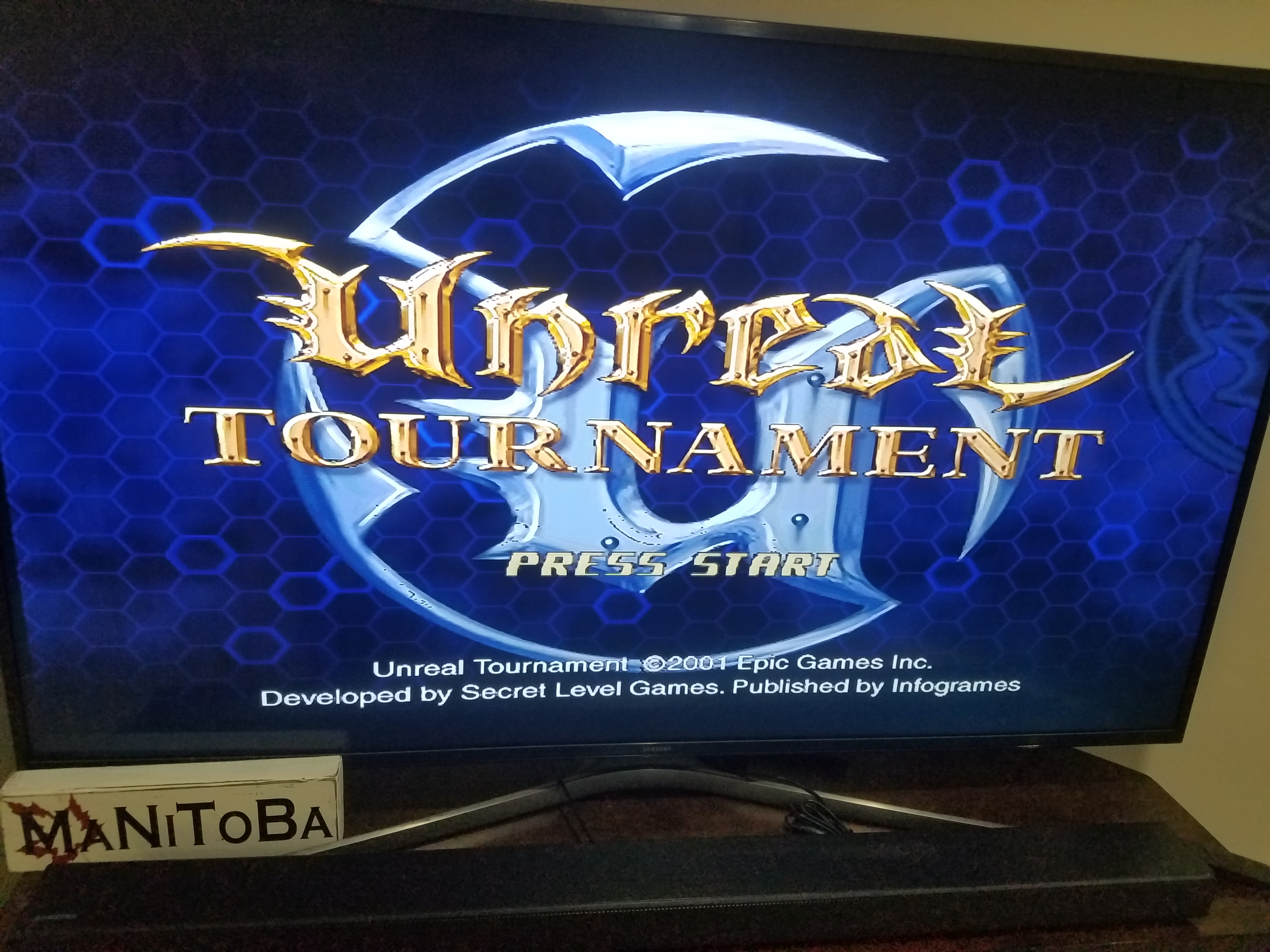

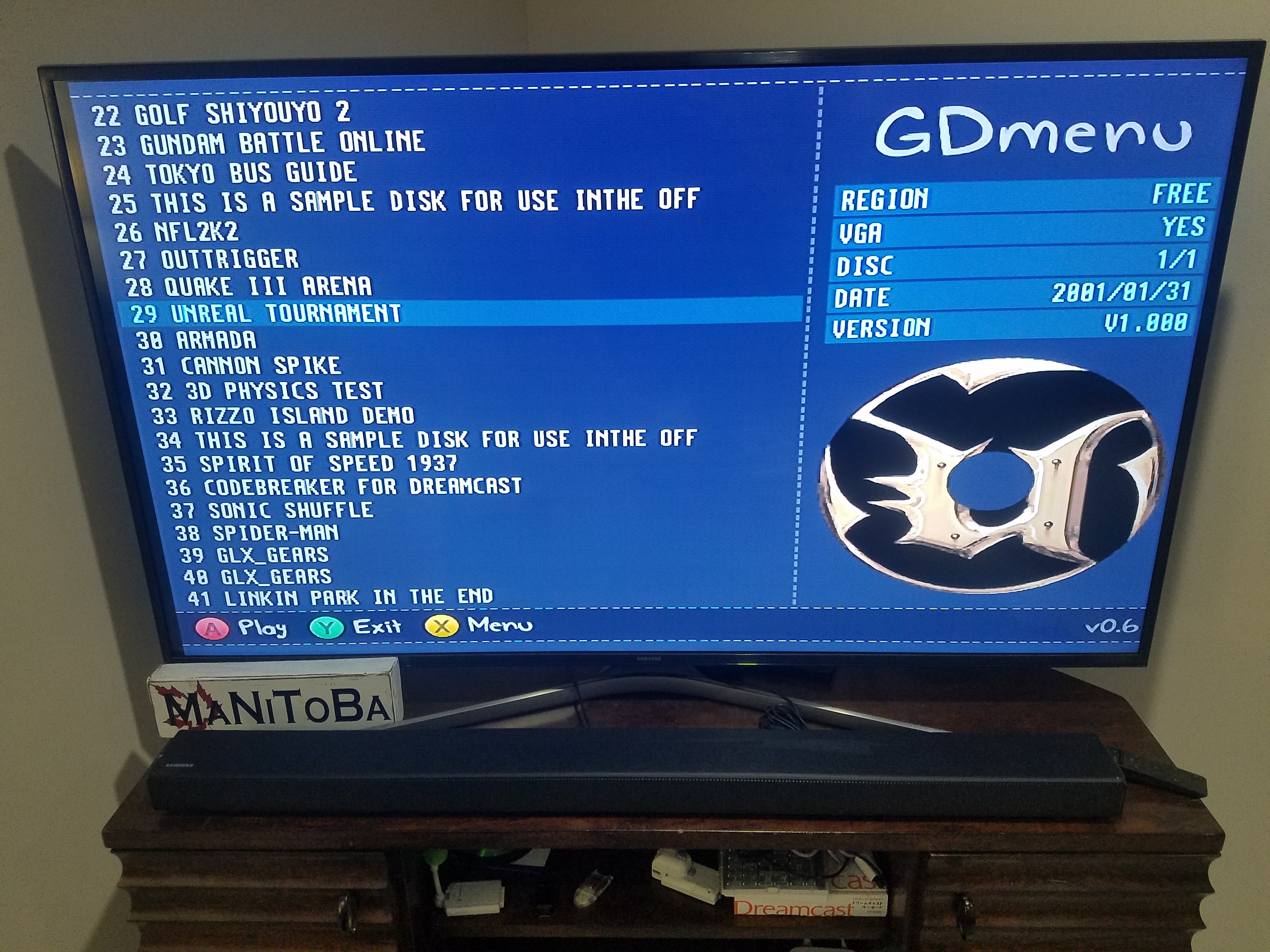

    GDEmu clone 5.5, ntsc va1 DC. Clone is dated 4/20/18. With tosec unreal
    renanbianchi and AUSTIN PEYTON like this.

    Oddly enough, board is stamped v5.5 but GDMenu reports v5.15
    It's on the silver card but I doubt it wouldn't work on the gold.
    If you're on windows I suggest formatting your card with the official SD formatter. It has always done well for me

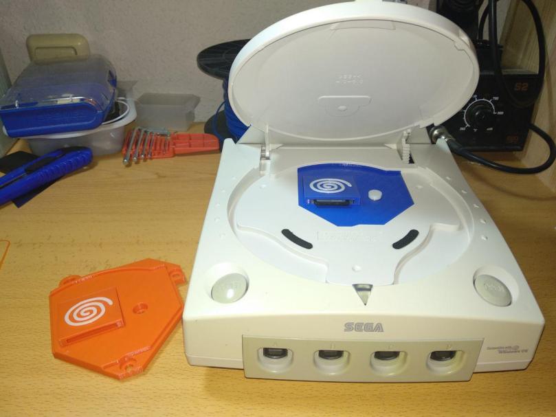

    Well, if you were to have these things made by a 3D printing service, it's going to cost about that much. The one from Javi in Spain looks a lot nicer.
