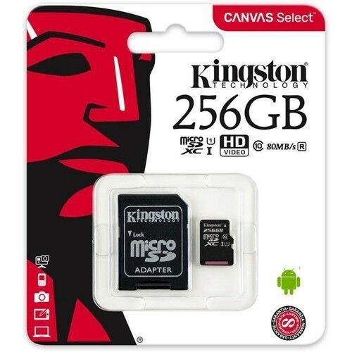

    Hello everyone, been a lurker for a few years who registered a few years back. Got a clone GDEMU and thought I'd share some things I ran into so far.
    1. I bought a 256 GB Kingston card with the intention of fitting basically the entire NTSC-U library + the PAL exclusives + some NTSC-J games (I wanted to get all the games on a single card because I wanted a 'get it done once and never bother with it again' solution, and I didn't want to get multiple cards that I have to swap back and forth based on what game I want to play). So I bought the following card which so far seems to work perfectly.

    I only chose that card because it was the cheapest I could find in the 256 GB size.
    I can't comment on other Micro SD cards, but so far all of the issues I ran into seems to be due to rebuilt images, as when I put the untouched 1,1 GB images on the same card, the issues are no longer present.
