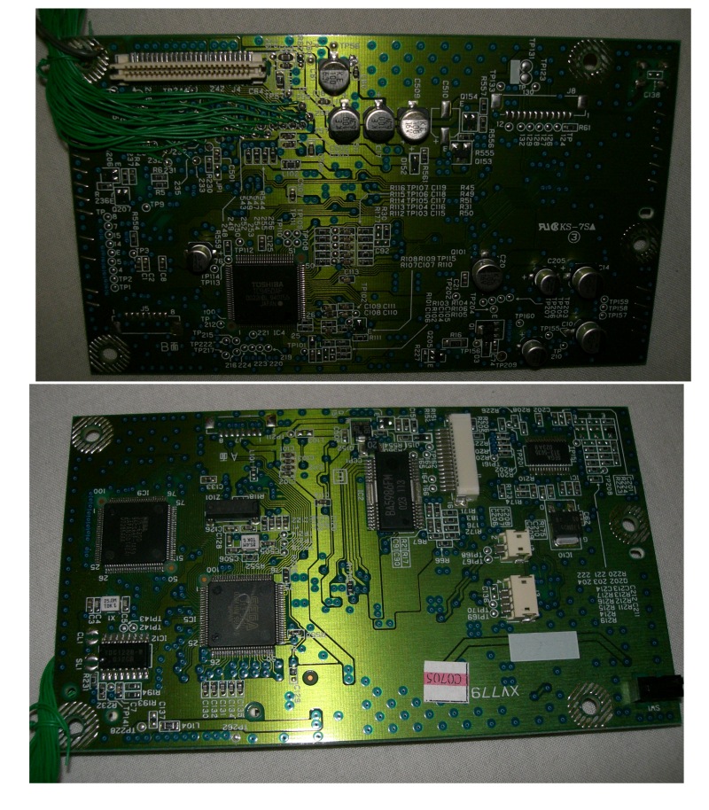

    Yeah, he is gutting the boards for the chipsets on them which are a finite resource, so that is the only reason he needs these. You can't exactly get brand new controller chips for GDRom boards.
    I was quite taken aback by it too when I read about it the other day. I guess it makes sense because this device replaces both the actual disc drive AND GDRom controller right? I mean controller is even in the name. Top fucking kek.
    http://3do-renovation.ru/USB-GDROM_Controller.htm
    Edit: Guess it is these chips. I can't get a clearer view than that.
    Double Edit: Only other semi-clear picture II could find of the controller board without taking apart my own systems was this which was modded.
    I can see the Toshiba chip at least looks similar, but the ARM chip is new. Maybe he uses the actual connector as well as the other smaller chips too?

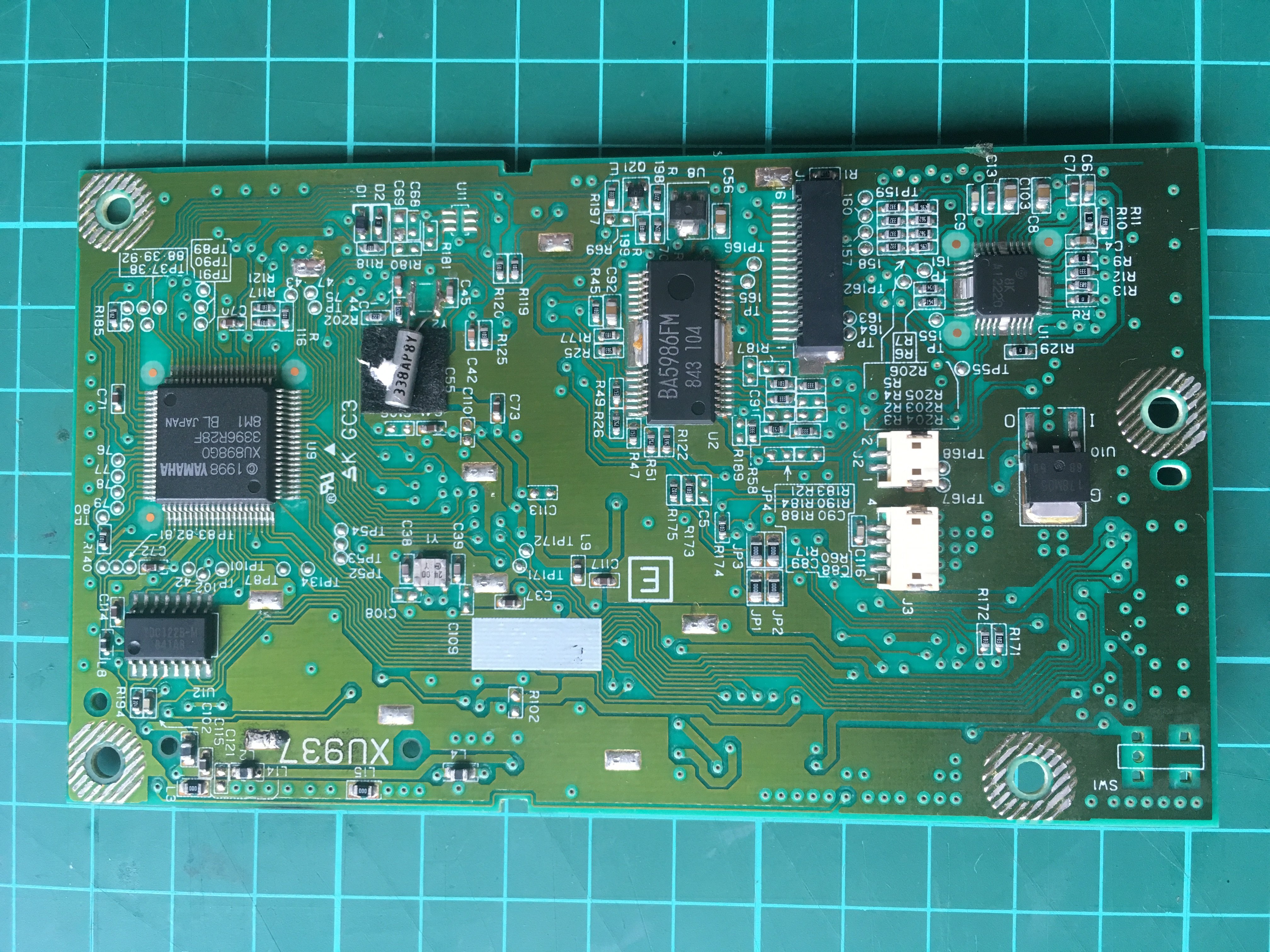

    This has been talked about before in the "Let's make GDROM Emulation happen...." thread, but I'll go over it in more detail here.
    So the USB-GDROM uses an ST ARM microcontroller (some Cortex-M3 one) in conjunction with a Toshiba TC9466FA CD-ROM decoder with 1Mb buffer RAM. This chip is what actually interacts with the Dreamcast, so he doesn't need to emulate the communication to the Dreamcast at all. He just needs to emulate the disc side communication to the TC9466FA with the microcontroller, aka emulate a Toshiba TC9450AF. But because he does it this way he's reliant on being able to source that Toshiba IC which probably stopped being produced over 10 years ago.
    This chip is not what is actually used in any Dreamcast (as far as I know), but it is very similar. The GDROM drive with Toshiba chips uses what I believe is a TC9410BFA, marked as a SEGA 313-5640 (IC 5). This does not have an internal buffer, so instead the GDROM drive uses an external 128KB buffer. The equivalent part on the Yamaha drives is the Yamaha XU916A0.
    The OTI-9220 is indeed from an earlier Dreamcast, it is also present in Katana drives. It pretty much does all the CD-ROM stuff in a single chip.
    "Oak Technology’s OTI-9220 is a 4-in-1 single-chip CD-ROM solution containing an IDE/ATAPI interface, CD-ROM decoder, DRAM buffer, digital signal processor (DSP), digital servo control, and digital-to-analog converter (DAC)."
    I imagine they switched to Toshiba/Yamaha because they are Japanese companies.
