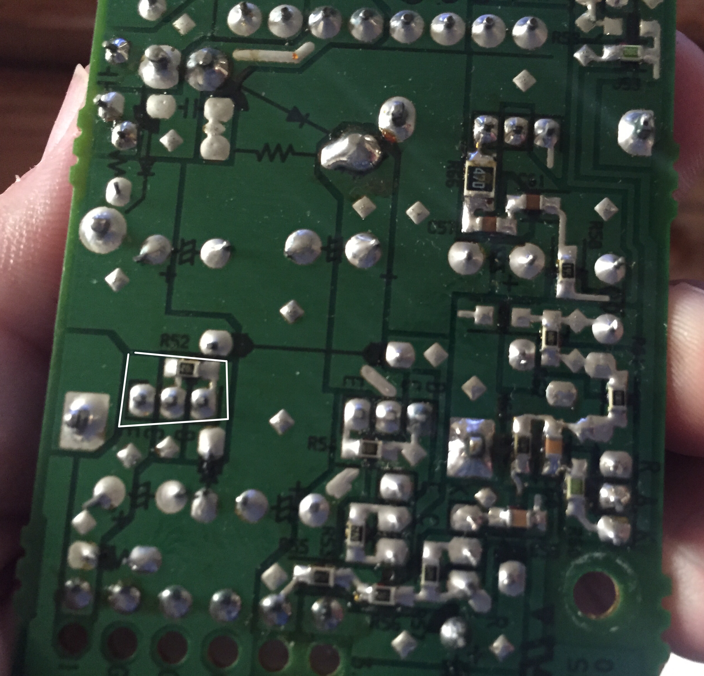

    124
    DID not work.
    Desoldered the 3 pins. Pulled out the Regulator (which was secured with a screw,
    Also Removed the Resistor.
    Blank screen with USB GD ROM installed.
    REsoldered back in.. Fired right up.

    Nov 8, 2013
    36
    You do not need the 12 volt rail. I've removed it on 2 DCs and USB GD-ROM worked fine in both without 12v. On one of the DC I ended up replacing stock psu with PicoPSU not even hooking up 12v. USB gd-rom works fine even with Toro box hooked up. Not sure why yours did not work.

    I know it Did it correctly. I used my desolder pump. Undid the screw. Sucked the 3 points and the regulator fell right out. The Resistor I used my hot Tweezers. Melted the solder on each side and lifted the resistors right up. Placed them to the side.
    POPed in the usb gdrom. Turned it on Black screen. Tried GDEMU card too. Neither gave me a pic. Even tried booting it with no gdrom drive or card attached. Nothing.
    Removed the power supply soldered it back in. Turned it on and worked perfect. But I now have 12V rail active.
    Was using composite cable for testing.
    Perhaps I'll try a different DC.
