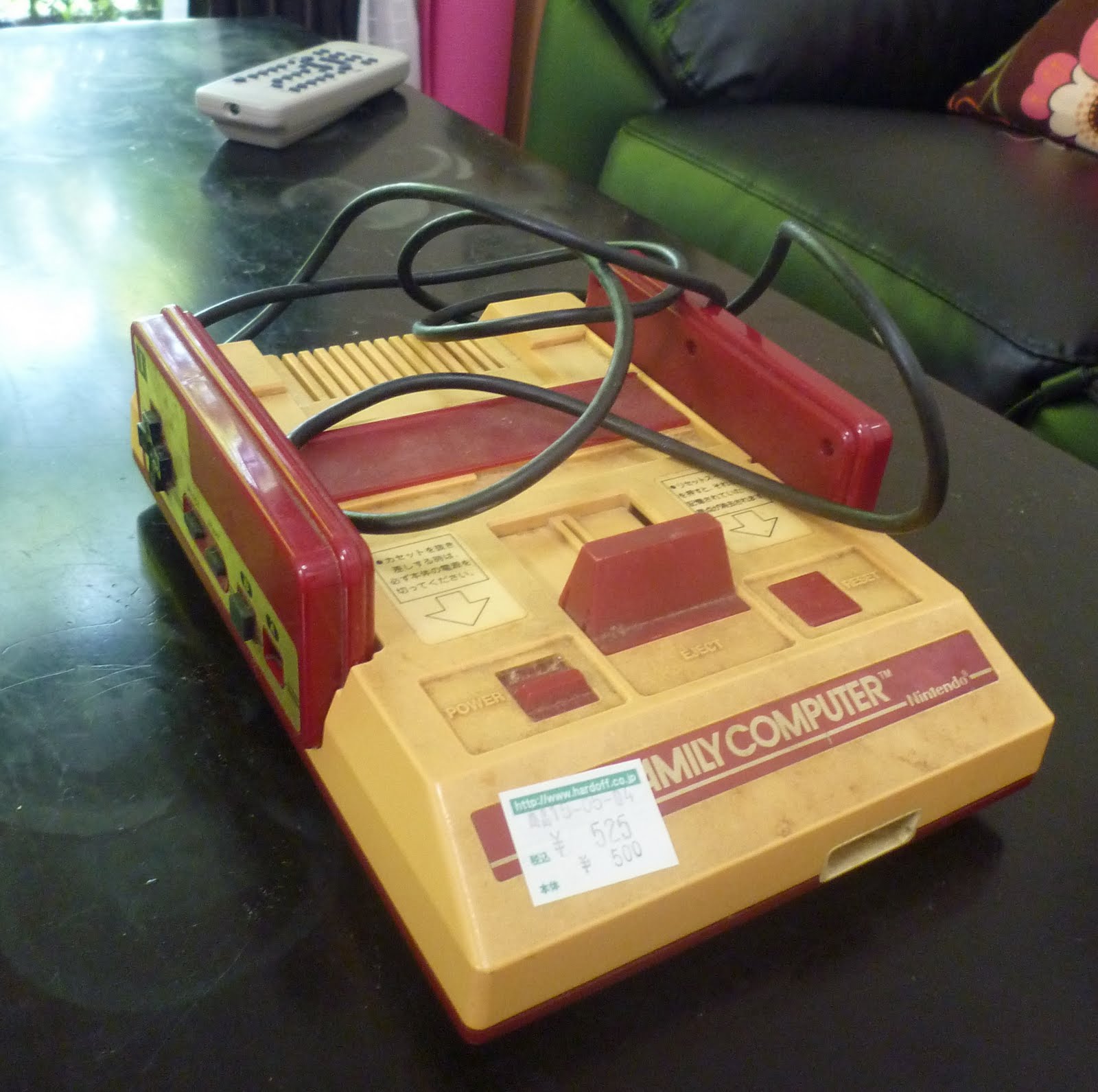

  8. Tatsujin
    Tatsujin Officer at Arms
    Nov 24, 2005
    3,614
    Just found a pic of yours famicom ^^
    But you're a lucky guy, you got a square-buttoned one^^

  12. relo999
    relo999 Robust Member
    Jan 29, 2012
    236
    I actually reversed image searched that famicom: http://famicomblog.blogspot.nl/2010/05/square-button-famicom-my-new.html It has the serial H1346565
    Mine is: http://cgi.ebay.com/ws/eBayISAPI.dll?ViewItem&item=331075977226&ssPageName=ADME:X:RTQ:US:1123 H1148560 and originally a smooth bottom, which is a lower serial so with some luck is the magical square button Fami. At the very least it doesn't look that bad compared to the other picture. We all know in about 2 weeks.
