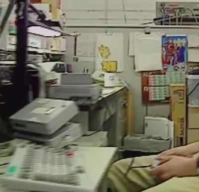

    A video recently surfaced showing inside Nintendo's offices during the SNES era.
    I think I saw this device a few times -
    Screen Shot 2016-07-29 at 07.48.16.png Screen Shot 2016-07-29 at 08.15.45.png
    The video (which you may have already seen) -
