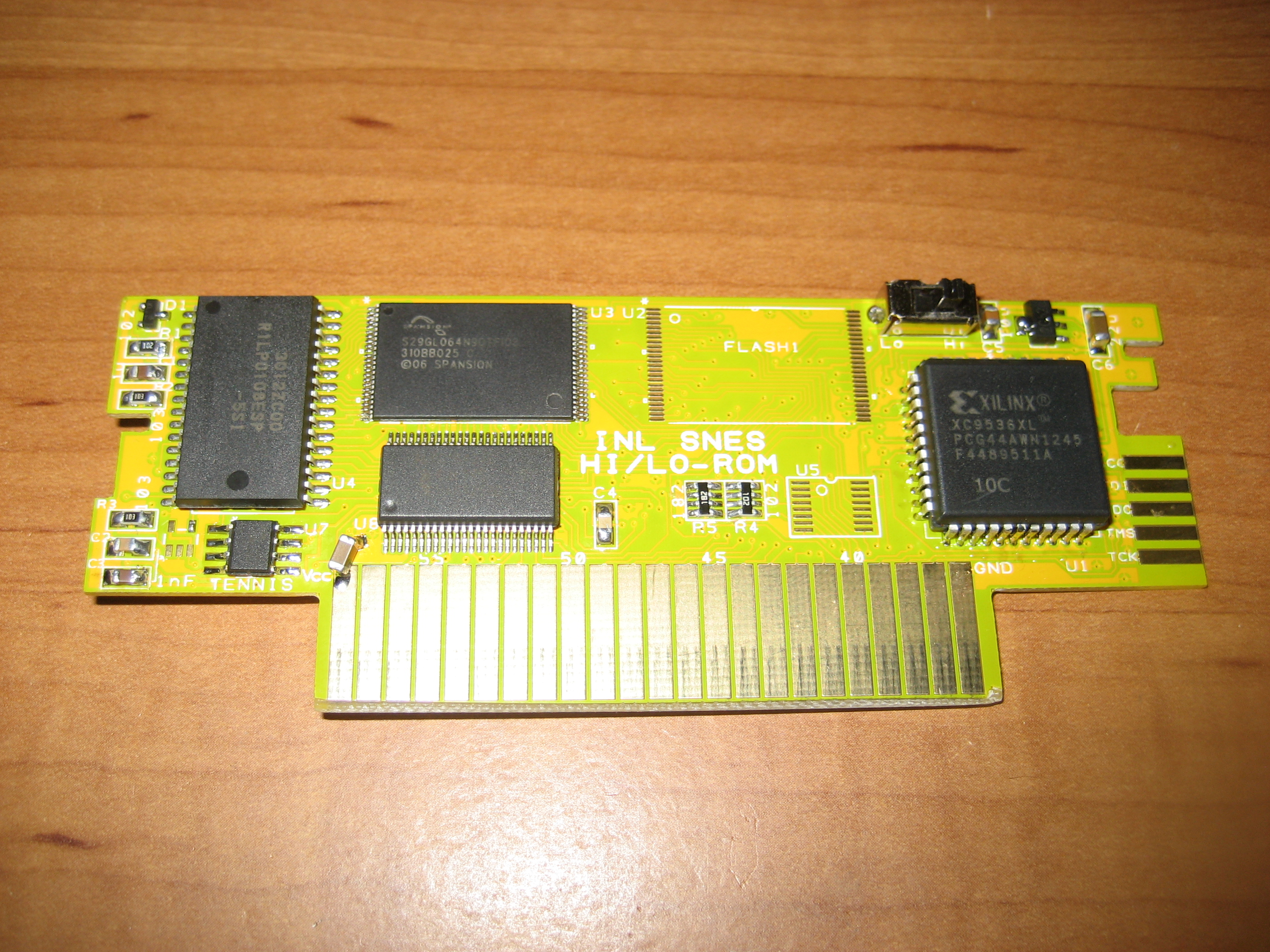

What kind of SFC flashcart is this?

    Post a pic of the cart too, and the back of the board.
    That board has some quality components on it.
    I've seen them from real early bootlegs from china, you'd never get quality like that now.

  5. TriMesh
    Jul 3, 2008
    2,324
    Looks like recent production to me. First of all, it's using a PIC to emulate the CIC - and that code only became available fairly recently. Secondly, it's using a 3.3V flash with a couple of diodes to drop down the 5V line - which suggests it was built at a point in time where LV flashes were substantially easier to get hold of than the 5V ones.
    Can you get a better closeup of the PIC? (the little 8 pin small outline chip on the left).
  6. Yakumo
    It's a reproduction cart. My SFC reproduction carts look just the same :) although mine all use official SFC cartridge shells with the security screws.

    Here we go:
    http://i.imgur.com/HRiGGj7.jpg
    Took the picture through a magnifying glass XD
    So where do you get your PCBs? I'm curious what kind of stuff the Japanese homebrew/repro/etc scene uses.

  11. TriMesh
    Jul 3, 2008
    2,324
    1513 = Week 13, 2015 - so it was built no earlier than about March last year.

    Anyway, not meant to belittle anyone. I just don't think you are likely to find out who's knocking these out. It's probably used by a few fabs. (And done cheaply as there is no proper level shifting).
    This has been done many times:
    http://www.infiniteneslives.com/img/images/SNESHiLo.jpg
    http://retrostage.net/SNES board.jpg
    https://i.imgur.com/rklY50oh.jpg
    http://i49.photobucket.com/albums/f257/wgpearcelb/IMG_2261.jpg
    http://www.snescentral.com/1/0/0/1008/Snes8in1_pcb_front.jpg
    and many MANY more.
    The english speaking ones are easy enough to track down, but the chinese ones not so much and theres been loads of them over the years. Affordable PCB creation to the masses ends up with this.
    Look at all the stuff on OSHPark (and this is just the people who shared their stuff, there is many times more people making stuff daily).
    https://www.oshpark.com/shared_projects
    I'm quite surprised no one has uploaded a PCB for the snes to oshpark yet. There's quite a few genesis/megadrive ones.
    @graphique you didnt seem to mention where you picked this up from. Was it aliexpress (obviously going to be a bootleg), eBay or some forum?
