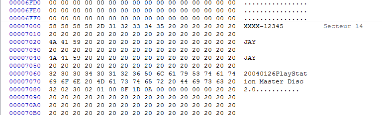

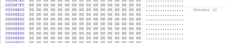

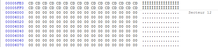

  18. kennypecheur
    May 19, 2014
    1,101
    337
    Hello I_oliveira,
    Thanks a lot for your help !
    Yesterday, I have solved my issue. My disk was finally a mastered one. Sector 12 and 13 were empty, but sector 14 and 15 were filled with master data, as you can see below :
    Sector 12 was empty, this is why I was thinking that the disk hasn't been mastered.
    Anyway, on the last pict, you can see the game ID XXXX-12345.
    Finally, I was able to play the disk on my DTL 30001 E, after another dust removal. I hope that the laser unit will stay in working condition.
    Anyway, Thanks a lot for your help ! :)
  19. sp193
    sp193 Site Soldier
    Mar 28, 2012
    2,217
    1,052
    This also means that Loser's documentation on the Master disc boot sector isn't complete. At least, it doesn't mention that sectors 14/15 can store the Master Disc information instead of 12/13.
    kennypecheur likes this.
