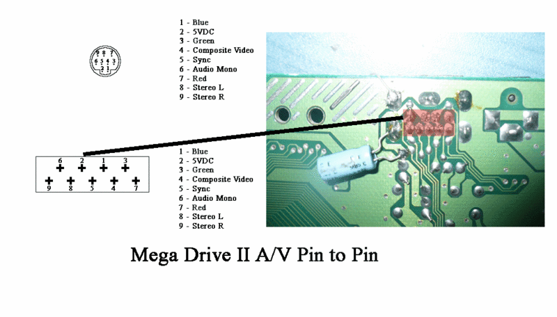

    A SOIC-8 adapter is a little PCB that allows you to adapt an 8-pin surface-mounted chip for through-hole usage, here's what one looks like:
    I use them for THS7314s and they've become essential for me. It makes it much easier to work with the THS7314 since you're not soldering components directly onto the legs with this.
    Anyway, here's the gist of the diagram. For your RGB inputs, you can grab them from either the HuC6260 chip, or even better, you can get them from the expansion port connector (no soldering onto tiny surface-mounted pins this way). From there, your RGB inputs will each pass through a 0.1 uF ceramic cap (micro's schematic calls for 82 nF ones but I was able to substitute them for 0.1 uF caps without any issues) before they go to the respective input pins of the THS. After you've done that, you need to wire 5.1 M ohm resistors to the output ends of the caps and tie the other ends of the resistors together to 5V. The schematic calls for 3.6 M ohm resistors but calpis suggested using 5.1 Ms in another thread here, so that's what I used. That about does it for the input end.
    For the outputs, you can use 220 uF caps instead of 330 uF ones just fine. Each positive lead of the cap goes to the THS's outputs while the negative end of each goes to a 75 ohm resistor. Of course, on the other end of each 75 ohm resistor will be your final output. You'll also need to grab 5V and ground for the THS, but you'll need to add a decoupling cap across the voltage and ground pins to protect the THS. The schematic calls for a 100 nF ceramic cap and a 22 uF cap connected in parallel, but I only added the 22 uF cap as I thought it was enough.
    Hope that clears it up.

    Ah, so that's what those holes are for! I'm assuming that you need to solder the wires to the correct holes right? How do you know which is the correct orientation? I'm assuming the square in the corner tells you somehow.
    Also, for the mini-DIN connector, how do you know which pins lead to what socket? Are they numbered or do you just use a multimeter?

    The power decoupling cap is the 22 uF cap going across the 5V and ground pins of the THS7314, not the caps for the outputs. Again, VCC is 5V; VCC is a standard term used to refer to the voltage pin of an IC. You can't use this exact same mod for the Famicom/NES, but there is one that uses the same amplifier chip used here, which is what Drakon was referring to.
    It should be obvious as you can tell by looking at the traces going between the solder pads for the chip and the holes. The square-shaped hole on the particular example I posted is usually used to represent VCC, but there's plenty of SOIC-8 adapters that don't have this.
    Again, just follow the pinout I posted and you shouldn't have any trouble.
