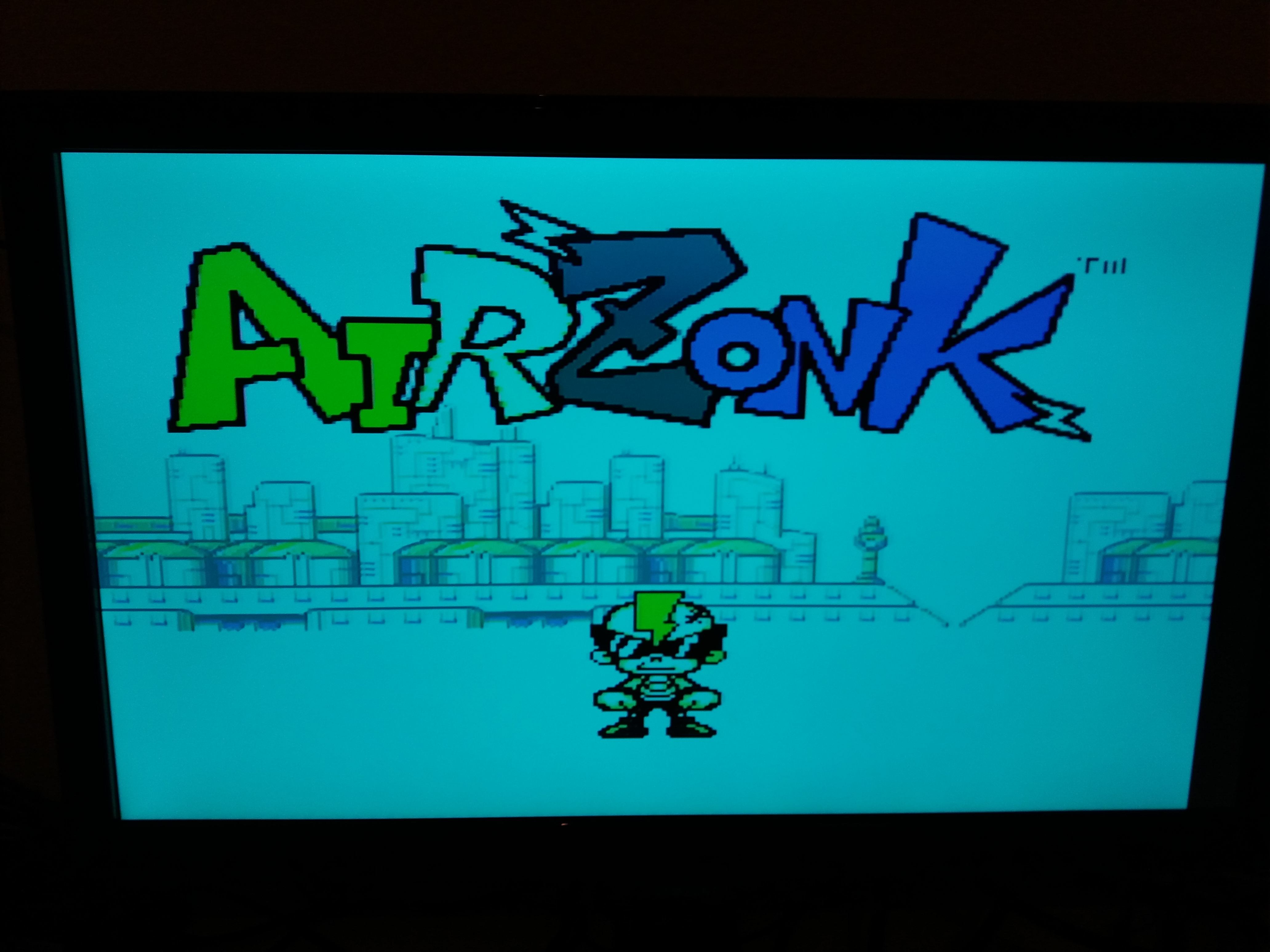

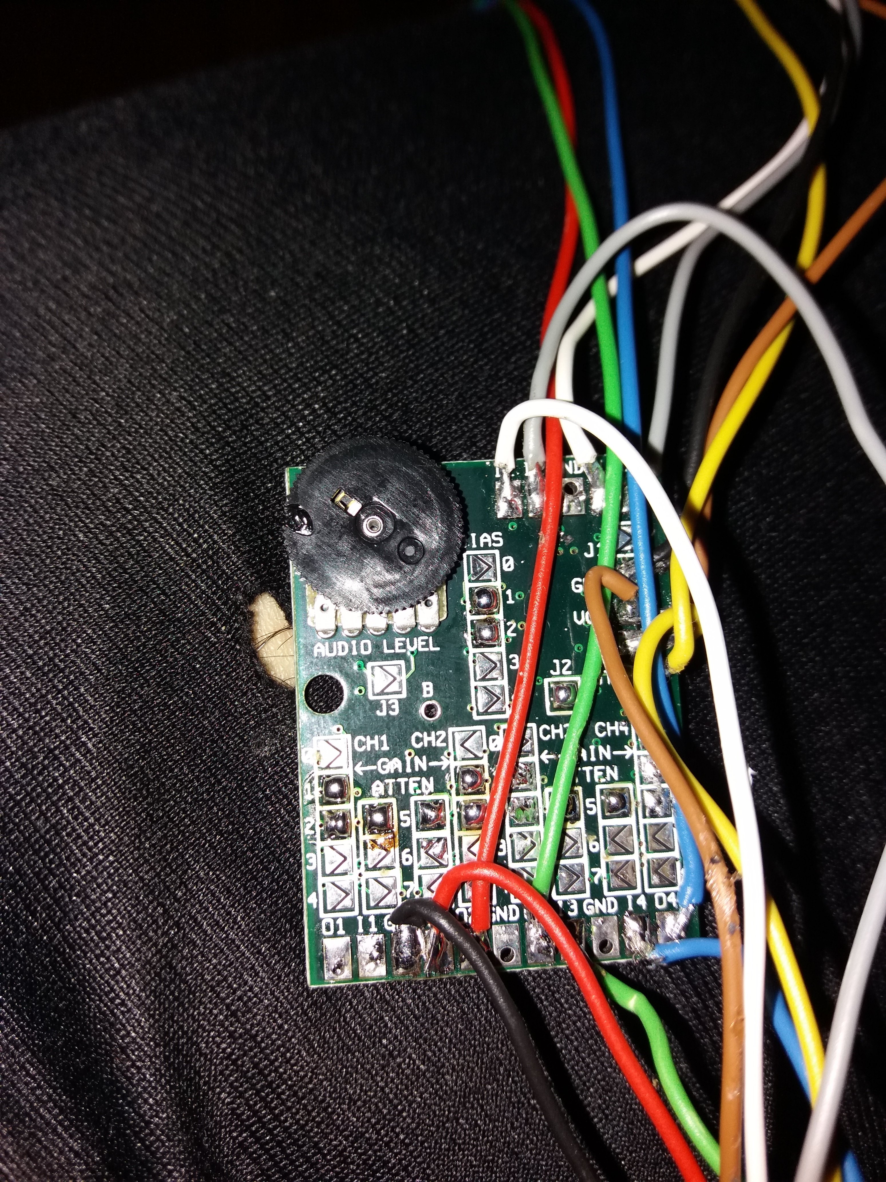

    A small update to the thread as I got the AV driver.
    Soldered the jumpers as seen on this youtube video (jump to 5:38)
    and then my wires,in an attempt to make this an enhanced external RGB cable. I apologize for the mess, I soldered everything temporally , just to verify everything is ok. R, G,B signals are represented by red,green and blue wires respectivly on I/O 2,3,4, black is gnd on I/O1 coming from pc engine. On the right side, gnd goes to the gnd line on the scart cable respectively (black wire), two cables for +5 coming,one coming from the console and another for the scart cable (brown), and two yellow wires for sync (one coming from the console, the other going to the scart cable).White and gray wires is the audio.
    when I power the console, I get this image
    (again sorry for the 16.9 ratio, it was a quick test )
    On composite, colors are normal.
    What am I doing wrong?
  19. Ronnie
    Ronnie Spirited Member
    Sep 13, 2012
    132
    40
    ^ looks like its missing RED.
    Now, on the spoiler driver pic above looks like a GND (black wire) and red wire are tied together, is it supposed to be that way?
  20. snobgamergr
    snobgamergr Spirited Member
    Aug 29, 2015
    No they are not tied , blame the angle I used to take the photo :)
